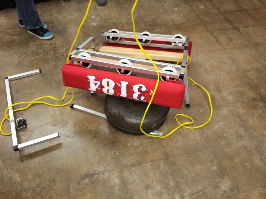

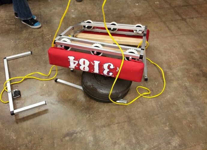

pic: FRC 3184's drop test results 2
Last night we took out test frame, weighted in down to 155lbs. Lifted it to 7.5ft off the ground…and let him go!
On its way down, the bot flipped over and ultimately landed on its head. This was a very accurate test for the frame because if we were to fall off the top bar, we would hit the lower rung and flip over.
To anyone that’s planning on hanging from the upper two bars, be careful! Falling really hurts robots.

Another reason our team didn’t choose to climb to 30. The sacrifice of the frame was worth it to prove the damage.
what did it do to the floor?
Our big thick concrete floor survived with little more than a scuff where the robot impacted.
We use a similar connector from a different vendor, I wonder what it would have looked like had the connectors been pinned to the extrusion instead of just pressed in.
Some of the connectors appear to have sheared in the other picture, so it doesn’t seem like press fitting vs screw/pin fitting would make a difference.
