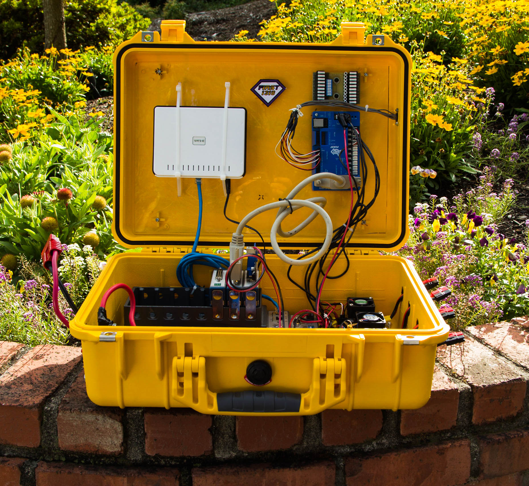

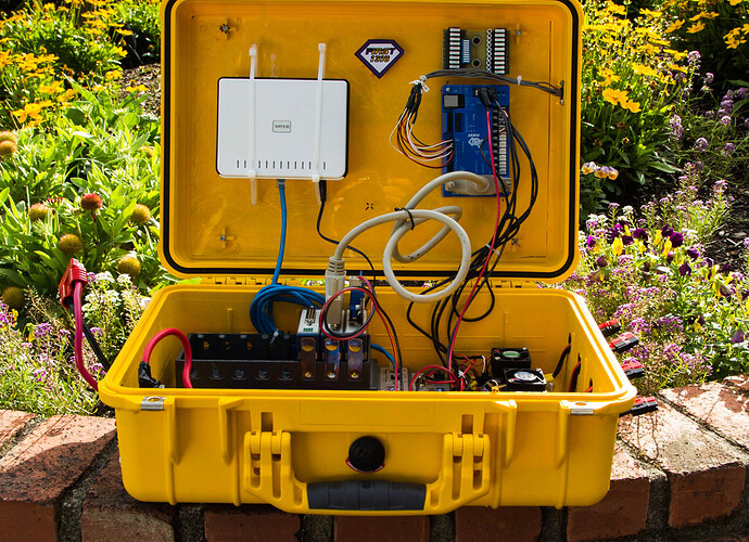

This summer we decided to pack to FRC control system into a pelican case for use with prototypes and troubleshooting. We are currently working on making a similar box for pneumatics that will plug into this box for crio control.
This is really cool! i’m interested in trying this now
AndyMarks box came out just after we started the build and didnt make sense four our desired aplication.
the showcase is bigger, only has 2 talons, drives around(not what we needed), no support for external motors or inputs and outputs for pneumatics, sensors, encoders, and doesnt work with box closed
Nate checked the case. Wow! This is a nice case!
that’s neat! And if you do something about the connections to make them water tight, you’re half way to being ready for a water game
i really like this idea. What size Pelican case did you use? Have you though about adding a fan to the system?
we used a pelican 1500 case. We have a plan for adding a fan if needed but have been watching the temps and haven’t had a problem yet with the box closed.
there will definitely be a fan in the pneumatics box to cool the compressor

I have been thinking about doing something like this, but 3D printing the case so it fits exactly, and make it modular so it can be directly placed on the robot. It’ll probably protect the electronics from the Aluminum shards that tend to short them out all the time!
If you were to mount this on a robot, would you close the case or leave it open?
I understand its a bit of a silly question but I am wondering if you know of any performance implications it may have on the router. I think some teams had issues with their router being covered and having little connectivity issues.
We usually use it closed and have not had any issues with the router
The issues with the router being covered was caused by the metal robot parts blocking the signal. A plastic box is transparent to radio waves.

Our current plan is to wire up a quick disconnect terminal to the pneumatic break out and mount thru the wall of the box with the control system in it similar to how we have the encoder’s wired. We then will make an identical connector in the pneumatic box but wired to the solenoids instead of the breakout.
We will then make a wire connecting the terminal on each box and another one from the pneumatic box to a panel of switches that will be 3d printed
