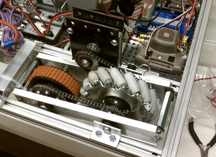

Looks like you have the best of both worlds. Where are you going to place the piston? I’m having a hard time visualizing where you’ll be mounting it.
What configurations are you going to have your wheels in? I.e. four traction only, four mecanum only, 4 traction + 4 mecanum, etc.

Only one is down at a time traction for power then you switch to only mecanum for maneuverability.
maybe where the ziptie is?

Why did you chain all the drive wheels, instead of power one of the directly and derive power off that wheel?
How much does it weigh? (without a super structure)
Where does the piston mount?
That is going to be a very fun drive train to watch, just like 217 and 148 last year. How much does it weigh? and Why did you put the mecanum wheels on the outside?

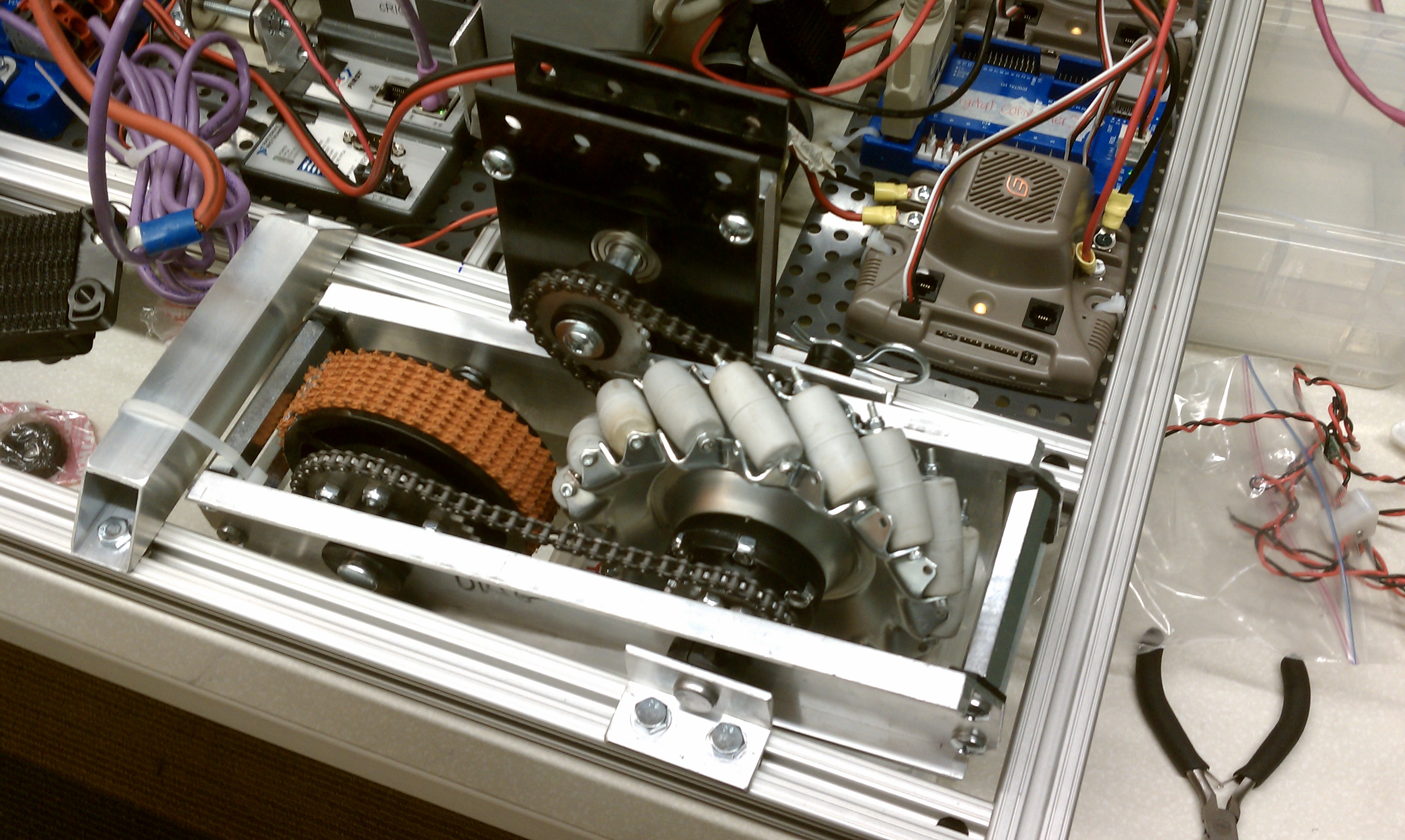

The wheels are going to be actuated by two pistons – one along each side of the robot. It’s hard to visualize because all of the hardware associated with that system is still missing. We’ll add a vertically mounted arm to each wheel pod that the piston will push or pull upon. This creates a four-bar linkage where none of the links are grounded. The 1x1 cross piece that the pods are currently zip-tied to will act as a stop for the pod rotation and, effectively, ground one link of the four bar.
In retrospect, it would’ve made more sense to actuate each wheel pod individually, but the system we’re implementing is a bit lighter. As a result, we can only run on all mecanums or all traction wheels.
There is an additional 22:32 reduction between mecanum and traction right now, in addition to the difference in wheel size – 4" vs. 6". We may experiment with this some more.
Yep!
I tried to make direct drive of the mecanum wheel a reality, but AM’s “long” output shafts were not quite long enough to make it plausible. It would’ve simplified a lot of things, certainly.
I am not certain of its weight. We’ll try to weight it today, but I’d guess it’s around 50/55 lbs.
Mecanum wheels are outside because they’re geared faster than the traction wheels and we wanted the widest wheelbase possible to accommodate rapid changes in direction. Putting the traction wheels on the inside also makes it easier for the robot to turn while they’re in place.

Could you elaborate a bit on that please… How does making the wheelbase longer accommodate rapid changes in direction?
Rapid direction changes + Short wheel base + tall manipulators = Tipping
The longer the wheel base, the less likely you are to tip when accelerating hard or coming to a hard stop.
However, mecanum is not at all like full blown swerve. The bot tends to drift a little bit as the rollers spin which should help remove some of the problems typically associated with rapid direction changes and tall manipulators. That being said, I still would not change direction at full speed (or even drop those traction wheels) if I had any sort of large mass up top. But knowing what I know about 488 they will have thought that out already (this ain’t their first rodeo with mecanums).

I’m very curious as too why you put the traction wheels on the inside as to opposed to the outside. As of now it appears that you are not really taking full advantage of switching wheel base sizes. Why not put the traction wheels in the longer wheel base configuration to make it that much more difficult to turn as opposed to the mecanum wheels which could be made to preform equally well on the shorter (inner) wheel base?
