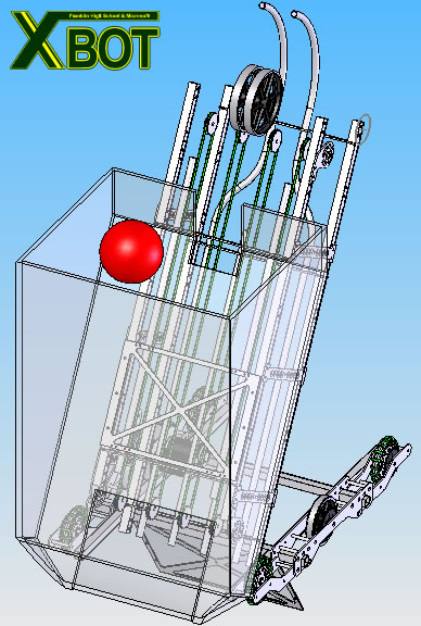

This is not a teaser. There is nothing hidden nor implied by this image. If you don't see it, I haven't designed it yet. The design is not yet finished, clearly, but it's coming along quickly now. The hopper remains along with some motor mounting schemes.
Ask questions and I'll answer them to the best of my ability. No nonsense.
This is our plan so far for 2006. It's a pretty straightforward design and strategy that is borne from the suspicion that many people will not be able to shoot as well as they think they can and that a large-capacity machine will be useful for scoring 1 pt. balls. It does have a provision for shooting, however, just in case we're wrong. :slight_smile:
I Like, Very Elegant. just looking . seems like you drop the hopper down to drop balls into the collector feed to launch. Beautifully skeleton look and the adjustable chassis for chain tension, Id love to see how that works out.
Yes, that’s exactly how the hopper works. We are useless without a working collector along the bottom, so why aggravate ourselves by trying to do something like that in duplicate? Instead, we’ve opted to reuse the same mechanism to load from the hopper and move balls up to the shooter, should we opt to use it for that purpose. The hopper also will have a method for gravity-feeding the 1-point corner goals that is not displayed. It’s way down on the list of things to do. :slight_smile:
The chassis isn’t adjustable for chain tension in a specific sense, but rather, is completely modular. The modules that hold the transmissions, motors, wheels, chain and sprockets are self-contained and can be removed from the robot after removing four bolts from each side. I’ll see if I can’t find a picture of the unassembled chassis to show what I mean.

I am not trying to nitpick the rules here but rather gain a better understanding of how to interpret them. It is my understanding that the pictured design would not pass rule R4:

We were originally thinking of having a “door” that opened to allow balls to exit into the lower goal but have since changed our design specifically because of this rule. While neither your design nor our original design were designed to intentionally flip another robot they both appear to violate this rule. There are parts of the robot between 0 and 8.5 inches from the floor that are not within 10 degrees of vertical and can come into contact with other robots. Your design has a inverted wedge but the rule doesn’t specify the direction of any wedges. In your case you are more likely to flip yourself than the other bot but I think FIRST would also frown upon bots driving up on other bots. Please, please, please don’t take this as a slam of your bot design. I personally think it is a wonderful design. I am just unclear as to how the inspectors will rule on it. I am intending this to spark a discussion of how strict the R4 rule will be enforced and what is and isn’t allowed. By a strict definition of the rule I don’t think your design would pass but by a common sense definition I think it is great. I am wondering what other teams are thinking and how they are designing around this R4 rule. Are ALL the bots going to be square boxes from 0 to 8.5" up???
I’d been planning for 1/4" round urethane belting – McMaster-Carr part 59725K704 – but the Senate may overturn my veto of automotive V-belts. :slight_smile:
Thanks for the head’s up, Chuck. I hadn’t interpreted that rule as anything other than a way to discourage teams from engaging in questionable offensive and defensive tactics. It will be easy enough for us to square off the lowest part of the hopper so as to keep it vertical while maintaing the curved profile we need to load balls into the conveyor, however we had no considered that a gravity-fed ramp to the corner goals would also be construed as a wedge.
I’m not certain, even now, that such a ramp would be prohibited by this rule. The last sentence reads, “If a mechanism or an appendage (a ball harvester, for example) becomes a wedge that interferes with other robots, penalties, disabling, or disqualification can occur depending on the severity of the infraction,” suggesting that a functional mechanism outside the initial constraints is not considered a wedge (if more than 10 degrees off vertical) by default. Instead, they’ve used the word “becomes,” which implies that it would be okay to use for its intended purpose alone.
I’m interested to read some others’ interpretation of how we may be affected by that rule – particularly anyone who will be an inspector or referee in Portland. :slight_smile:

One question, how do you go from the wide collecting base to the shooter wheels?

Beautiful design. How are you aiming the shooter? (If that’s not giving too much away)

I’m not so certain it’ll work. In fact, I know it won’t work as shown because the two center rails are missing an endpiece that would keep balls from falling into the gap. I suspect we’ll need some larger funnel walls on the sides to coax the balls over to where they need to be.
We’re also considering running the conveyor belting on one side on a slightly different pulley size so as to make its speed a bit different. We hope that will aid in relieving any congestion between balls on the way up.
I have some ideas for physically altering the trajectory of the ball but haven’t given their implementation anything more than a cursory glance. Essentially, the rails would end at what would be our highest angle of attack – about 45*. A cowling or shield would rotate about the same shaft as the shooter wheels and extend beyond the rails. By rotating that shield, we’ll be able to adjust the exit angle. Of course, we’ll also be able to vary the wheel speed – with some precision, we hope – so as to vary the trajectory that way. In combination, those two capabilities will probably allow more control over the ball path than is practical, so I doubt we’d use them in tandem.
