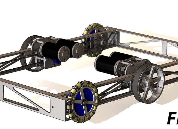

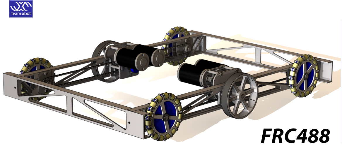

pic: FRC488 - Six Wheel Drive Chassis
Iteration is everything in design. We’ve been working to reimagine the 6WD design we’ve used for the past two seasons into something that’s cheap, quick to manufacture in our shop, light and elegant. Naturally, as the latest iteration, I think this is the closest we’ve come to the perfect 6WD design for our team.
A couple of questions:
Does that have any rocker in it? And is that 25 or 35 chain?
Why omniwheels on a 6WD?
Turning, I’d say. Instead of lowering the center wheel, why not use omni’s? It’s more stable and more maneuverable. (It’s also easier to spin around by hitting.)
If the bumpers are back and the design is like 2006, then the next step is to add mounting to this frame that would allow the bumpers to be a structural element. If the rules allow forget home center plywood. Baltic birch “wood” be a good choice.
Not necessarily more maneuverable, But I bet it is nice to have the 'bot spin around it’s center set of wheels instead of whichever four happen to be touching the ground :rolleyes:
Wow, looks light! Do you have an estimated weight for the entire drive base?
And on the subject of omniwheels: It looks like with the setup you have it would be very easy to swap them for traction wheels if they are needed. I guess that would be decided in testing.
Can you explain why you chose not to have a cross brace? I’m not a mech-e but I would guess you need one.
The wheels are all in line – there’s no ‘rock’ at all. The chain is #25.
Because the center wheel is not lowered at all, at least one outside set of wheels should be omniwheels to alleviate friction while turning. I chose to put a set on each end because there’s no penalty to in line pushing force, generally, and I like to subtley encourage our drivers to avoid conflict. :slight_smile:
I’m now looking at a mounting scheme that will accept bumpers and protect the wheels from impact. I’ve never put bumpers on a robot before, so I’m looking at examples of others’ work to get an idea how to best accomodate the additional weight of the bumper assembly.
Our 2005 robot had a lowered center wheel and the tipping action drove me and our drivers crazy. It’s an impact to the system each time the robot’s inertia shifts and that starts to lead to annoying things like loosened bolts and the like. Practically, it’s cheaper and easier for me to make omniwheels than it is to make traction wheels and it’s certainly cheaper than buying them.
As shown – which includes everything but stiffening gussets and a base upon which to mount electronics, it’s 29.5 lbs.
The omniwheels are riding on 5/8" keyed shaft, while the AndyMark performance wheel is broached for a 1/2" hex shaft. It’d be relatively easy to change out a set of omniwheels for a set of traction wheels with a little bit of forethought. Namely, I’d need to make some shafts that are 5/8" diameter with keyway on one end and 1/2" hex on the other.
I’m waiting on the game before adding cross-bracing since I’m not sure if I’ll need a scoop or something on one or both ends. I’d like to, if weight allows, put an aluminum plate (1/16" or so) across the bottom to add rigidity.
I noticed that the front and rear c channels are notched for the drive rails on top and bottom. This could be a weak point. Shouldn’t the drive rails fit inside the c channel leaving the channel uncut ?

Looks quite nice, and you have obviously put a lot of work and thought into the design. The efforts to minimize the total weight are obvious. The biggest concern you may have is strength in the event of an impact or collision. You might consider making the frame members out of rectangular tube instead of channel. Given the amount of material you are removing, the additional weight from the fourth side of the tube will be minimal, but there will a considerable increase in stiffness of the frame assembly.

I took Dave’s advice and added the fourth wall to the front and rear cross members as a start. Because these drivetrains are almost never operating absent some additional mechanism or superstructure, I try to incorporate those future additions into the design and allow for them to be used as support for the drive in the same way that the drive supports the mechanisms, if that makes sense. I try to design such that the finished robot appears organic – not as if it was designed in pieces that were smashed together later.

Madison, I know that you have no broach capability, so I’m curious- where do you buy your #25 sprockets? I can’t find any finished ones online, or in the Browning catalog.
