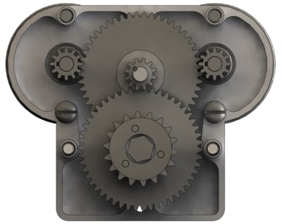

Do you guys have a shaft coming out of the tranny for the middle wheel as well as 2 sprockets on the inside leading to the front and rear wheels? Are the sprockets inline? Wouldn’t you need gears on the same axle as the sprocket to drive the sprockets in that case? Are the sprockets on the same axle? In that case how can your wheels be inline? Are the sprockets on the wheels on an offset?

The gearbox at the center of each side has an output shaft that drives the center wheel. Two 18 tooth sprockets are coupled to that shaft and, via chain, drive the wheels at the front and back of the robot. Those sprockets are not in line – they are offset 1/4". Our wheels remain in line because the sprockets on either end mimic the offset of their corresponding center sprocket.
Attached to this post is a cross-section of the gearbox that may help make the gearing arrangement a bit more clear. Excuse that the gears aren’t meshed properly, please. :slight_smile:
