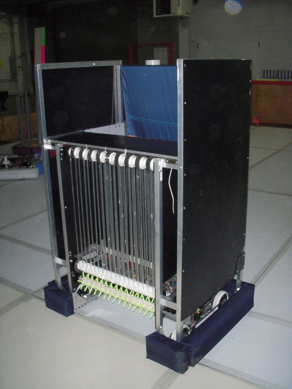

pic: FRC488 - Team Xbot's 2009 Robot
Video of a systems test: http://www.youtube.com/watch?v=_gpkF8Ptau4
Taken at the practice field late Saturday night. The black paneling is temporary and will be replaced by polycarbonate sheathing with our team identification on it. It will continue to be opaque, though.
Some information:

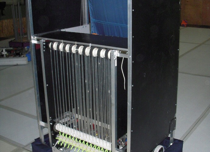

– 4WD with 1 CIM motor per side, geared at about 8:1. We have “traction control on demand” for straight line acceleration but have found that our drivers like the robot to be a more loose in the turns.
– Conveyor features front and rear, independently driven urethane belted mechanisms, each powered by a FP motor geared at about 39:1. We can load empty cells from the floor and store them in the conveyor and are able to return them to our payload specialist.
– Hopper capacity is 20+ balls and it can unload in 2/2.5 seconds. The hopper is itself a fabric “bag” that is rolled up on a drum to raise its floor to the top of the robot. It is powered by two CIM motors at 8:1, though we’re considering speeding it up some.

The major mechanisms haven’t changed since kick off, actually. The structure that supported them, however, was completely rebuilt a few weeks ago. So, while we’d always intended to use the fabric hopper, the frame that it lives in was not designed well enough to deal with the troublesome nature of the balls the first time around. It’s now considerably more stout and the balls move freely through the robot regardless of number.
Part of me expects your opaque hopper will cause you to accidentally (albeit rarely) incur <G24-A> penalties. Are you counting on it being offset by the fact that referees will have just as hard of a time determining if you are in violation?
The thought has crossed my mind. The front panel will likely become transparent as a consequence and that should allow our drivers to be sure that we don’t have more than one empty cell in our possession at once. We’d like to keep the hopper opaque, however, so that other teams have a more difficult time keeping track of how many balls are in our possession.

The hopper can hold 20 balls. Our testing shows that the number of balls that make it into a trailer depends almost entirely on our distance from the trailer. Maybe saying as much is obvious, but it really makes a big difference. In ideal conditions, 95% of the balls make it in and the accuracy drops from there as the distance increases. :slight_smile:
