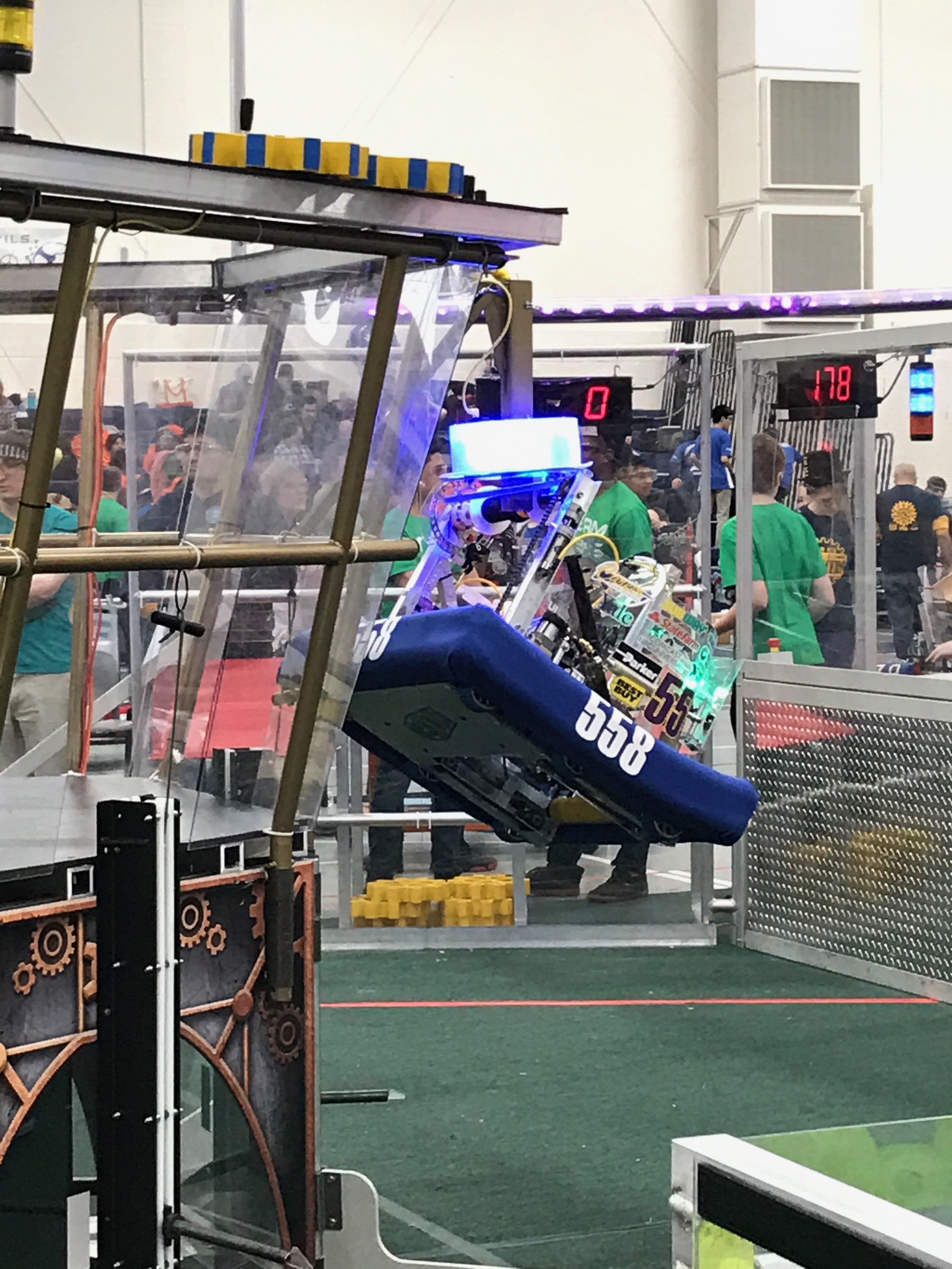

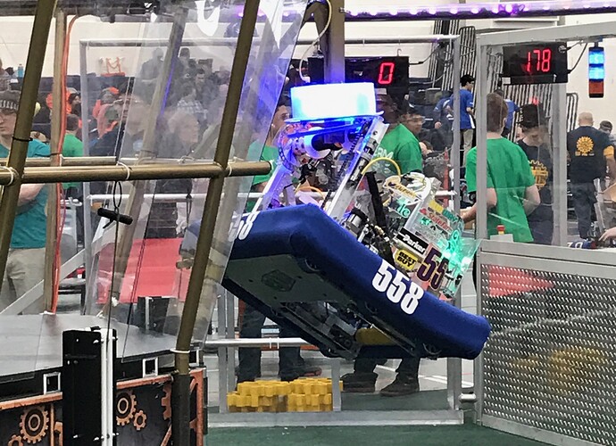

How is your rope loop made? It pulls out incredibly quickly.
Is climber always running off one side of the drive train?

Looks like a small piece of velcro sewn on
The team thanks you for all the positive feedback, I’ll do my best to answer your questions. For the design of the intake it’s best to go right to the sources of inspiration for it, we used frc4481’s double roller design to get the gear to the right height and frc2200’s backplate and polycarbonate “spring” concept.
As for our rope, it is indeed a small piece of hook and a small piece of loop about 10-12" apart that we stick together to create our slack loop. We did this so that it would be the same every time and we would not have to rely on knot.
The climber is running all the time off of one side of our drivetrain via an additional 3:1 chain reduction (it was 2:1 at the beginning of Hartford but we were able to find and machine a new sprocket on Saturday afternoon thanks to frc181).
