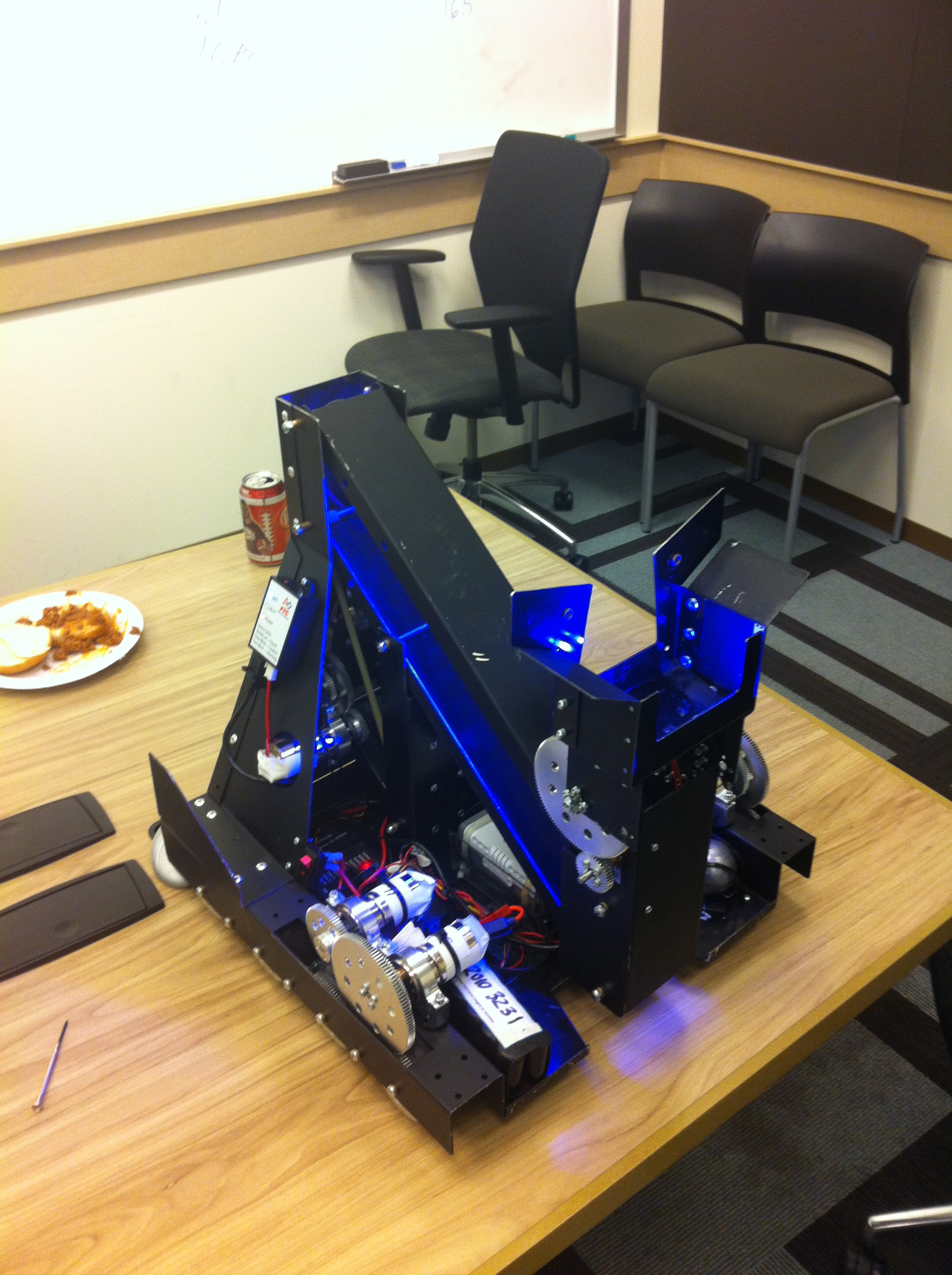

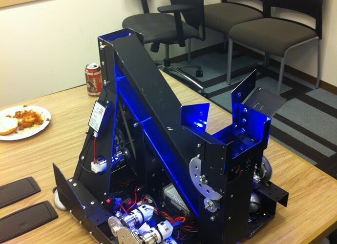

Our FTC season is only a bit longer than FRC season, so our teams begin competing tomorrow. Consequently, they start off a bit simpler than robots that show up later in the competition season.
The new material allowances gave the team an awesome chance to exercise our new sponsor some more and learn about sheet metal design – and how it important it can be to get things right the first time. :slight_smile:

It works like you might expect; a simple-four bar (driven by a 67-esque lower four-bar) raises to the rings to any of the three scoring heights. It has PID control on the arm and drive for positioning.
The manipulator isn’t a claw; it’s more of a bucket. It slides up into the rings from below and pulls them away from the pegs to load. It can rotate forward to dump rings onto the pegs.

Do I see a double 4 bar; like 67 in '07 and 148 in '11?
Seems like it.
Its a 4-bar 4-barring a 4-bar :smiley:
Technically…it’s a 6 bar (4-bar with a driver dyad).

Yes – the arm is a 6-bar like those used by 67 and 148 in the past.
I wasn’t able to make it to the first league match on Friday night – I didn’t get done with work until they were nearly finished – so I couldn’t get any video. They are 6-0-0 at the moment with a high score of 240 pts., though, if that means anything useful.

This. FTC5210 had a sheet metal sponsor (nothing fancy, they provide material and will do the cutting and bending by hand) last year as well but they couldn’t do a lot to help us due to material requirements. This year we have been able to save a fair bit of money by not purchasing Tetrix material.
I agree completely. I think 3231’s robot could have been made using the kit metal and parts, but it probably would have cost significantly more due to the price of the tetrix material.
The great thing is that an FTC team could probably buy a small inexpensive break and cut the sheet metal out themselves using a nice set of snips or a saw. This would arguably also better prepare your team’s members for the FRC build season because you are forcing them to use a design methodology that can apply directly to the following FRC build season.
