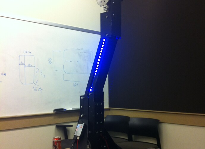

pic: FTC3231 Syzygy

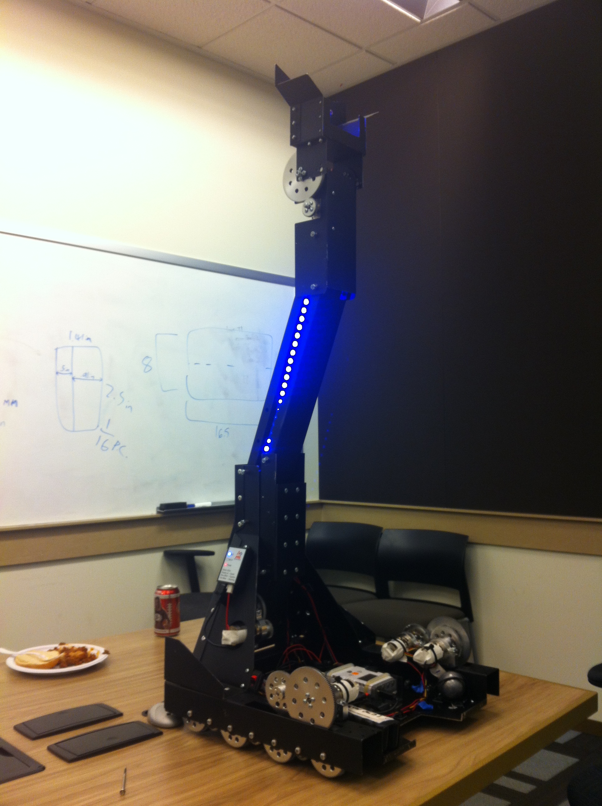

Here’s another shot of FTC3231’s robot for 2012 with its four-bar linkage at its highest position.
This makes me feel really bad about our FTC bot xD
Is that an 8-wheel drive? If so, how well does it turn? Are the center wheels dropped, or are there omni wheels hidden in there somewhere?
Amazing robot. I love the lights!
It is 8WD with the center two wheels lowered about 1/8". It’s using 3" diameter Tetrix wheels everywhere and turns great.
This is really awkward because our robots is named Syzygy as well.
Wow, what material is the black shell? It looks really cool and I want to use some for our team, is it easy to bend?
It is 5052 aluminum that the kids spray painted. Nothing too fancy.
