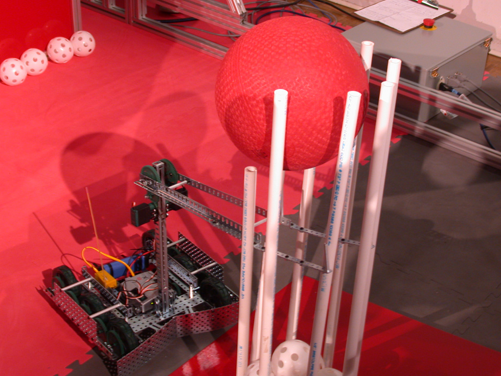

How successful were they at capping? And what else happened at the scrimmage?
If someone has a video of any Vex bots that would be awesome!
If my memory serves me right (been a long day) I think they capped the goal twice out of 15 qualifying matches and eliminations (10 teams). Other teams tried to pick up the big ball but failed because the devices they built weren’t strong enough to hold the ball (here comes the redesign). As you can see from the other picture only one team tried to hang and they were not that successful. If they reinforced their arm they might have been able to hang.
The scrimmage proved to be very educational to all of the teams and they still have two weeks to make their robots better so hopefully at Atlanta they will be able to do more.

Just a small correction - that would be FVC team 13 (Sharon Eagle Robotics Unlimited) capping the goal. Out of 6 qualifying matches, the team capped in the final two successfully - it was the continual evolution of a design that was planned only to cap the movable goal, but was modified for the extra reach needed to cap the fixed goal.

10 Teams (3 of students from 190, 7 others from other MA schools)

Same as FIRST, some teams were better than others. Average number of balls in towards the end of the day was about 4-5. I’d put shooting percentage under 50% in most matches (true for the winning alliance)

Typical score was 20-15. By the end of qualifiers they got a little higher. High score was 60 I believe. 50 was hit twice, once due to capping, once due to HP scoring only.

As far as I remember, no one got the mobile goal over with the ball off in time. Several got close but didn’t get the red ball moved quick enough.

- I believe there was only one time that both yellow balls were knocked off before 30 seconds, releasing the dump early. Very few times as well that the bonus balls ended up on the floor or scored.
- When there are a bunch of small balls against the driver station wall on the floor, it is very very hard for the drivers to see (much worse than the FRC game). Remind your stage team to look for them.
- Be careful of robots going into the HP Zone and HPs reaching onto the field to grab balls. Problem was equally, if not more prevelant than in the FRC game.
- Getting to the hanging bar has the same challenges of narrow passage or step up. The team that finally got to the bar (only occured once) took 3/4 of the match to get there. Then again, a hanging robot no doubt would have won every match. It’s value vs. difficulty is definitely worth discussion.
- Lastly, strategy matters. The winning alliance had a visible game plan when they went out for matches and it paid off. Simple and smart can take you far.
Hope this is helpful. I had tons of fun working at this event and the games got pretty exciting in the elimination rounds. Especially with the big ball through, it takes practice and building game elements to really be successful, so practice!
