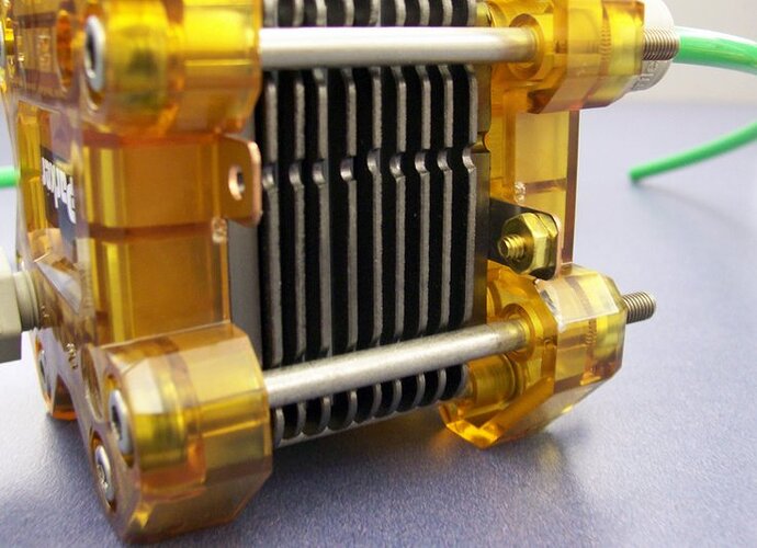

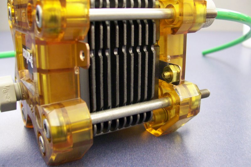

pic: Green Machine Competition - 10 Cell Fuel Cell Stack
1403 Has been participating in the Pilot Fuel Cell competition called the Green Machine Competition. The competition is divided into 4 parts, the first part was the Research phased, and that concluded back in November. After that phase concluded phase two, the experiment phase began after we received our kits. This is one of the fuel cells assembled, not yet in working order. It is a Parker TekStak 10 Cell kit, and when we supply some hydrogen to it, should cause some reactions creating 6 volts.

Well the amount of current you get, is very much dependant on the flow of the fuel (hydrogen) through the unit. We have the capability in the kit to have a forced hydrogen flow, or more of an ambient flow. So there is no definitive answer I can get you right now, but once we run a test I’ll post the results from the multimeter. In the mean time, you can look at some of the information on the TekStak page, they say 1.5amps, but we’ll be testing a system 4 times the size they talk about, as well as a hybrid battery/fuel cell system.

I am a little confused, I don’t see a PEM in the stack, and from looking at the picture of the plates, I don’t see how the gasses flow through.

The MEA (the proton exchange membranes) are very thin, and there’s one (and two surrounding PTFE gaskets) between each bipolar plate. The reason you can’t see them in this picture is simply because of the angle at which it was taken at.
This fuel cell system is “open breathing,” as the oxygen just enters from the outside into the spaces inbetween the plates. We got computer fans to increase air flow to the cell.
The hydrogen enters through the tube seen in the picture.

Yeah it’s a pretty lose fitting system, and not the most efficiently way you would think but it’s cost effective and produces a good bit of electricity. Fans included in the kit not only make it more efficiently by cooling it, help it produce more electricity. Because of the design, the first time you run it your supposed to run it essentially on no load to help it flow better.
With a 1 cell stack, it would be pretty hard to get 1 volt, let alone 1 amp out of it, unless it was really big.
Well i know it enters through the tube, but what I meant is how does it flow from plate to plate?
Connor can you get a picture up of the PEM? Do you know what brand PEM they use? I know Nafion is basically the best out there right now.
