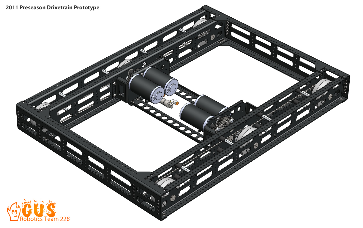

pic: GUS Team 228's Prototype Sheet Metal 6WD Chassis
As one of our 2011 preseason activities, we updated an older prototype 6WD sheet metal chassis we had designed back in 2008, since both our 2009 and 2010 robots were 4WD.
The main chassis rails are 1/8" 5052 powder-coated aluminum, with the middle lateral supports being 3/32" 5052. Unlike the past two years where our sheet metal parts were mostly limited to our drive train, we plan on using a lot more sheet metal parts (particularly 3/32" and 1/16") on our superstructure and manipulators for the 2011 season.
The pneumatic shifting gearboxes use a variety of gears a la carte from AndyMark, and are designed for a low-gear speed of 5 ft/sec and a high-gear speed of 13 ft/sec. The center wheel is direct-driven, and the outer wheels are powered via 25p roller chain. The wheels are 4" x 1.5" Colson wheels with knurled 6061 aluminum inserts pressed into them.
With everything shown (including all hardware and simulated roller chain set to the correct weight), SolidWorks says this drivetrain weighs in at 36.76 lbs.
Probably a silly question, but what’s changed since the last design and why did you make the changes?
We went from single-speed to dog-shifting transmissions, from 5"x2" to 4"x1.5" Colson wheels, from 35p to 25p roller chain, from keyed shafts to hex shafts, changed hole pattern from #10 clearance on 3/4" spacing to alternating #10 clearance and 5/32" (for rivets) on 1/2" spacing, and overall dropped a lot of weight.
Also, the standoffs were modified to have a Delrin sleeve over them. As shown, it was designed for an exact number of even number of 25p roller chain links, so as to eliminate need for a master link. In this state the chain does not contact the standoffs, but as the chain stretches these standoffs can be moved to act as tensioner. Another benefit these standoffs have is it allows us to nest pneumatic accumulators into this (otherwise wasted) space to help keep COG as low as possible:
However, depending on whatever curve ball the game throws us, we may opt out of using these standoffs in lieu of a single sheet metal belly pan and/or sheet metal superstructure parts. If we had access to a live-tooling lathe, I’d combine the sprocket and knurled insert hub for the outer wheels into a single piece, to allow the end shafts to be dead axles.
I drew up a model similar to your 2008 model. One of the questions I had in doing that are what are the pros and cons of putting the chains on opposite sides of the driven center wheel versus having both on the same side? I would think having them on opposite sides of the center wheel would be easier, but then is there a mechanical reason for having them on the same side.
Looking at this model, why did you go with squares instead of triangles for lightening?
With everything shown (including all hardware and simulated roller chain set to the correct weight), SolidWorks says this drivetrain weighs in at 36.76 lbs What was the total weight of your robot, with the upper mechanism ?
Putting the sprockets on the same side (inside) adds almost an inch to the lateral wheelbase of the robot. This slightly improves turning by moving the angle of the wheel relative to the center of turning closer to perpendicular, which allows for a greater percentage of the wheel’s tractive force to be used in the desired direction rather than “wasted”.
Our sheet metal shop sponsor that fabricates our drive base uses turret-punch machines for their work. Slotted pockets are easy to punch out (punch two or four holes, then use straight punch to connect them). Triangular pockets require a lot of nibbling to make, which slows down the fabrication time. Since their time and work is donated, I like to keep the production time to a minimum.

How do you tell if your designs are strong enough? Do you do FEA? Something else?
If it’s a “unique” part we do calculations and/or FEA on the part. But for the majority of parts, we use past experience and intuition, as there isn’t enough time in the FRC build season to fully analyze every part. By managing flange locations carefully (flanges strain harden the material) and properly cross-bracing sheet metal parts, you can create strong structural members with relatively thin materials.
The most important thing when working with sheet metal is that many designs may only work as a complete system. Whereas many non-sheet metal drive bases work just fine alone, many sheet metal designs would fail without the cross bracing of all the other mechanisms and structure. For example, here is the chassis for our 2010 robot:

Some questions about this chassis in particular:
How much ground clearance is there?
If the game calls for an open front, do you have a plan for joining the frame members mid way?
Would it be possible to hex broach the Colson wheels directly instead of machining knurled inserts?
For the mounting hole pattern on the frame, I’m wondering if you could make them all 1/4" holes. This would allow you to choose either 1/4-20 fasteners, or #10-24, since 1/4" is the drill size required for #10-24 PEM nuts. So if you have a spot where you want to use # 10 screws, just put in a PEM nut.
I like the way you have designed in a series of holes to allow repositioning of the standoffs to serve double duty as chain tensioners. This is much more reliable than using slots to reposition a tensioner. Do you know how much excess chain length would be taken up for each position of the standoff?
