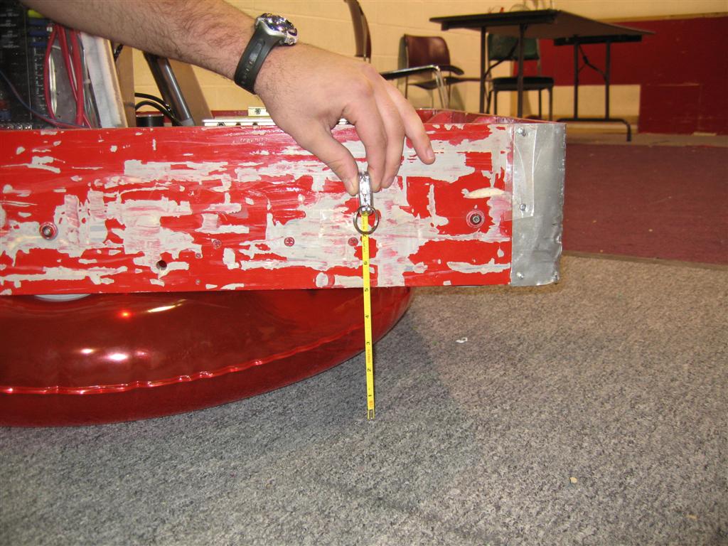

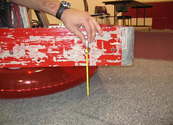

I figured everyone would want to see if a robot could actually sit on a tube, so here it is. This is RAGE’s 2005 robot sitting entirely on top of a ringer.
We’re still not sure if this is legal (if the tubes are part of the field or not) but we wanted to see what the height would be. The lowest point of the robot is about 4.5" off the ground.

The tape reads 5" at the bottom of the base. The wheels are the lowest, they’re at 4.5"
Also, we used the 2005 robot because the base is very flat and distributes the weight of the robot fairly evenly across the tube.
