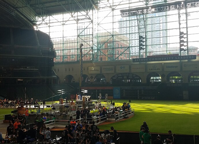

Should be interesting for vision tracking red side on Einstein in about 10 min.
Yeah… we missed out auto gear every single time because of it…
We lost our boiler vision aim pixy for both autonomous and teleop and for most of the matches could not see our backup flashlight that we used for manual aim and to set distance for shooting. We ended up relying purely on dead reckoning throughout the round robin and finals

Should of brought some black sheets for the windows XD
$@#$@#$@#$@#, you should have dropped using vision earlier! :wink:
The only reason we ended up with using the shooter at Madera was Mike telling us to use dead reckoning to get auto done in time.
For just using dead reckoning, I’m super impressed with your accuracy in auto and in teleop during the round robin and finals. Nice work.
There were also issues on the FTC field involving the sunlight. The teams would sometimes hit the buttons that correspond to the opposite teams color in autonomous. I am honestly surprised no one saw this as something that would be an issue. Good job to all the teams that were able to work past the obstacles though.
I thought being outside would be fun but after hearing this I am happy our “high tech” vision bot 2.0 doesn’t rely on light conditions (piece of electrical tape on our laptop screen :smiley: ), if you can see it with your eyes our software cough:live camera feed:cough can line us up!

I remember using a polarizing lens from sunglasses with the CMU CAM way back. It was very effective. Would it work with system with calibration?
