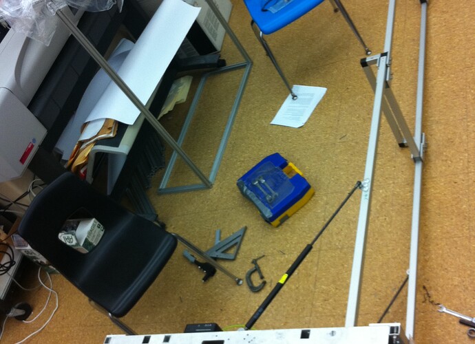

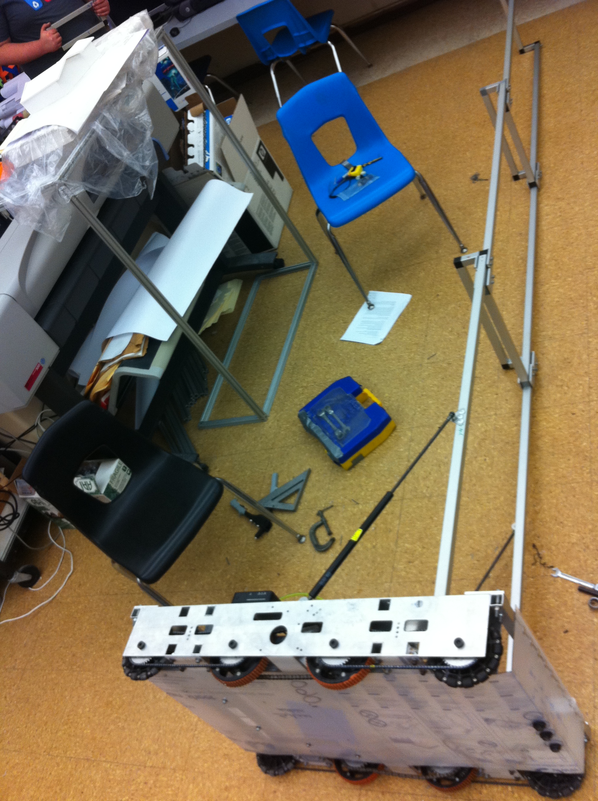

pic: I think we can...
Curious- are the gas springs actually articulating the lift up during the beginning of the match or are they just there for bracing?
A little of both and for shock absorbers
What are you using to keep the box tubings from sliding against each other?
Looks nice.
We will be using 1/16" nylon strips.
