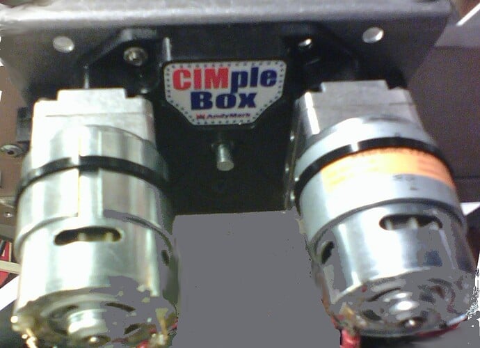

pic: In_CIM_erator
CIMple Box + ( 2 x CIMulator ) = In_CIM_erator
did you look at the specs for those rs775’s at 12 volts, at 18 volts they are pretty good, but at 12 volts they produce a measly 70 watts.
The 12v VERSION at 12v produces the measly 70 watts,
The 18v VERSION at 12v produces much more than that

I think you’re confused a bit. Motors are spec’d at a voltage, but will run at any voltage (although, they won’t last long once you hit a certain voltage).
A motor rated for 18V will run fine on 12V, it will just be roughly 4/9 the power of it on 18V.

The mechanical output power can be calculated from torque times speed.
If you take the motor at half free speed, it is also at half stall torque, for the 775 this works out to over 250W of power.
Where did the 4/9 come from. I must have missed something in my math.
Mechanical power is torque x speed.
Stepping down from 18 to 12V is a 2/3 change.
Power = 2/3Torque x 2/3 speed. Works out to the power at 12V being 4/9 that of 18V.

First thing, peak power is NOT peak efficiency. If you look a motor curve, you will find that efficiency is maximized at a much lower current than where power is maximized (at the intersection of the torque and speed lines).
Also, if using the electrical values to calculate output torque, you have to multiple the electrical power value by the motor efficiency at that point.

By the way, does anyone have documentation that BaneBots is using that particular RS-775 motor from Mabuchi? (I know there’s a part number under the sticker affixed by BaneBots…I just haven’t had the opportunity to look underneath and confirm it.) In the past, their motors appeared not to have been Mabuchi-brand.
(And just in case anyone is wondering, yes, this comes up all too often at inspection. Inspectors will often be noticing things like number and shape of vent holes and the colour of the plating on a motor, to quickly assess its legality.)
In fact, the same goes for the other BaneBots motors too. It would be instructive to publish a list of the manufacturers’ real part numbers (to forestall future questions about which motor is which).
In 2009, BaneBots shipped totally different RS-550 and RS-385 motors to FIRST teams, despite presumably knowing that there was an FRC parts restriction (given that they were a supplier of KOP motors), and without updating their website to reflect the changes. Given that previous miscue, we probably ought to be cautious.
Just curious about how you measured the power of the 775 vs the 550. Did you use a dynamometer? Or did you use the motors in a lifting application with a gearbox? Did you compare the work done over time?
The only info I have to go on is the motor curve provided by FRC, and the data sheet on the Banebots website. If you look at the data for the 18V motor, it maps pretty well to the FRC motor curve when run at 12V instead of 18V. I have to believe the FRC motor curve since we based our design on that. We won’t know until we get our gearboxes, maybe next week.
