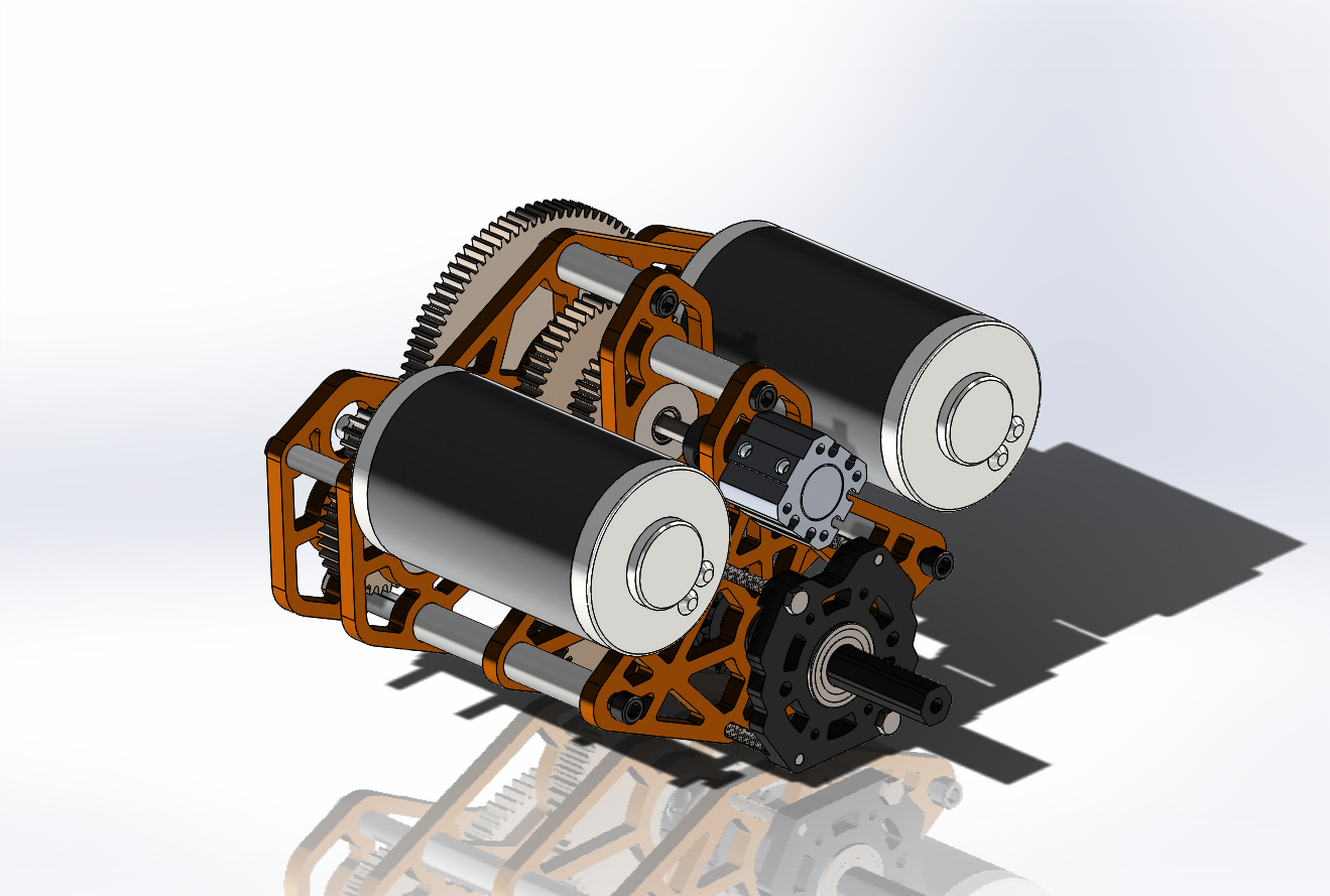

pic: Inverted 2-CIM Ball Shifter - 1st Attempt
First attempt at an inverted custom gearbox with VexPro ball shifting internals. The design goal for this is a bare minimum number of non-COTS parts, in fact the entire shifting cluster is unmodified. In addition to the side plates, the only machined parts are three different Thunderhex shafts (which could honestly be left alone by tapping the ends and using pan head screws instead of E-clips or undersized bearings). Packaging everything was a chore, hence the 84t 1st stage with idler gears. “Real Life” speeds are 14.5 ft/s high (5.19:1) and 6.1 ft/s low (12.35:1, 48.5 Amps pushing current draw). I used hex bolts to secure the CIM motors so that the motors could be serviced without removing the rear idler support plate. Since the Versablock up front also uses 10-32s, I’ve switched it over to hex bolts as well for tool commonality at the expense of a little weight.
Questions, comments or criticisms welcome, with any luck we’ll get to build and test one well before kickoff.
It’s tough to get the ball shifter shaft to work in this application. I’ve tried to package something similar to this (using the shifter shaft “backwards” and with the shifting gears as the pinions for the next reduction), and I’m never fully satisfied with the end ratios and the size of the whole thing. Could you potentially reduce size by shrinking the second reduction gear and adding idlers to keep the CIMs spaced out?
Otherwise it seems like a solid concept.

Has anyone used the WCP pocketed gears for a full season? Looks like I could easily shave half a pound or more with those.
Is that…4 parallel plates? :yikes:
Without looking too close on mobile, it looks pretty good. How much does that thing weigh though? It looks pretty beefy.
9.7 lbs with motors and hardware, assuming I remembered to apply correct material properties to everything.
We used the 2-CIM flipped DS gearbox from WCP this year. It had 4 parallel plates as well and we never experienced any binding or misalignment issues.
I am slightly concerned about overconstraining the main drive shaft, but that’s only passing through three Thunderhex bearings which I heard were more forgiving than hex bearings.
It sure would be nice if you could get rid of those idler gears and that extra plate! This adapter from Vexpro might help, it will let you put slightly larger gears on the motor shafts without having to machine your own pinion gears. You would probably have to adjust the gears used on the output (wheel) shaft to get the speeds you want using this approach, but it saves having to make several parts.
Heh, I actually have some of those adapters squirreled away for that very reason. Alas, the issue with the flipped COTS ball shifter setup is that I couldn’t get enough 2nd stage reduction before the driven gears got uncomfortably close to the carpet on 4" colsons.
Quick thought - how risky would it be to cantilever the idler gears if I was able to find a way to fit a retaining ring on the inside of the 3rd rail? That would entirely eliminate the need for the final plate.
Yes, we ran the pocketed 60T and 64T gears this season. They were fantastic, and are still running great after 105 matches and several more hours of driver practice and demos.
Fantastic. Switching the 84t alone saves a third of a pound per side.

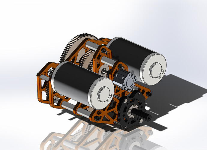

Added pocketed gears, reduced the rear plate thickness to 1/8", standardized to 10-32 screws. Brought the weight down to 8.9 lbs. I really want to find a way to double up on one of the middle plates but I also really want to avoid running chain-in-tube. The pneumatic cylinder might also hit the 4" wheel.
CAD for the curious: https://drive.google.com/open?id=1cfQTFQxMCPSqLZKo6a29jZkBNXoqc_jj

Holy snack cakes Batman, that’s a lot of custom plates. How may shafts are constrained over 3 points? I see the output, is that it? (shiftier shaft doesn’t really count)
Go look at 1477’s 2013 robot if you can find pictures. Repackaging a ball-shifter shouldn’t use more than 3 plates, the trick is to recreate vexpro’s ball-shifter gearbox layout as in 2 84t spacings but reorient the shifter shaft in order to flip the cims outward. That way you can also use the vexpro published speed- ratio tables and be able to easily change your high and low speeds throughout season.
In terms of custom parts in the gearbox, you should be at 3 plates, however many standoffs you like, and 2 shafts.
Speaking of space reduction, is it insane to want to use a CIM adapter and a 3:1 Versaplanetary stage? Can those be used in drivetrain applications if it’s well within the load rating guide? That buys me a significant first stage reduction, a 1/2 hex shaft, and a diameter reduction for cleaner packaging near the ball shifting cluster.
I’ve never done this, but I don’t think this is unreasonable at all. As long as you can package the longer motor (may be tough with the flipped gearbox like this), that can probably save you some reduction space in the spur stages.
