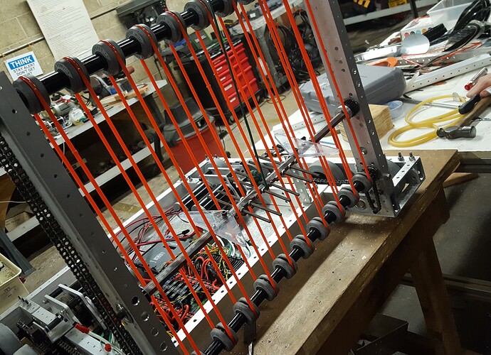

pic: Is it a climber or is it an intake?
Team 303 is finishing up machining as we begin to assemble our practice robot. You can see our poly cord intake with steel climbing shaft running through it.

Looking good so far. Excited to see this machine in action.
By the looks of the picture I am guessing both a climber and an intake by the polycord wound around the rollers. By the way where did you find that color?

Among other places, McMaster has the solid smooth stuff in clear and orange.
Looking good! Love the space saving design- very creative. We are looking forward to playing with you guys again at HVR.
Very clever, may I ask you what kind of rope is this? Or the source of. Looks a paracord, but I cant figure the diameter or more details…

Like the little colson pulleys! How did you cut the grooves?

Might I inquire as to how you plan to insure the touchpad gets depressed / how you plan to deal with the steel channel in the center of the touchpad?
The fingers and the polycarb plates would be sufficient to hit the touchpad unless they are completely parallel with the touchpad at the time the climber hits the davit. While unlikely, it could be an issue. And the shaft itself is recessed within the intake, so when the shaft is touching the davit, the polycord itself would be touching the touchpad, possibly putting enough pressure to trigger the sensor. Whether or not that in itself would provide the sufficient amount of force depends on the tension of the polycord.
We put a few on a hex shaft in the lathe and used a thin tool to cut the groove.
Our initial testing using a CAD calculated COM shows the top of the intake hitting the touchpad, we will certainly be testing that soon.

Looks great! Love the colors! Our current design triple-hats a single motor to power raise/lower of the arm, climb, AND do stage 1 and 2 floor intake, though it’s a gear intake, not a fuel intake. We have a vague idea that the fuel excluder will also push the touchpad, but that’s a week or two down the road.

We have something similar. Black delrin from McMaster and used a lathe to cut grooves in it.
How do you plan to attach the rope to the top of the airship? Just tie a big knot?
