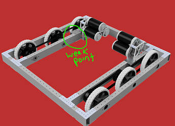

PIC: Looking for feedback on our drivetrain design

Somebody cut the wrong side of the drivetrain attempting to make a hole in the front for the balls to enter. Thankfully we had another drivetrain that we were able to take apart but replacing that part could’ve taken a long time(taking apart the other drivetrain took time too) but we have a lot of versaframe available if a wrong cut were to be made.
Thank you for your feedback. Are those rails custom? I have not seen versaframe with holes on that side.

Now a couple things I would suggest:
The way you have the gearbox mounted on the inner rail is certainly interesting, but it seems like a pretty weak point in that rail. I’m not sure that it is worth the extra inch of inside frame you are getting.
You are using hex shaft for all the wheels. I actually like using a 3/8" bolt a lot more in this application (like the kitbot does). It makes it so you don’t have to tap holes inside the hex shaft to hold it in place.
Now tbh, I’m not sure that this chassis is going to preform any better than the kitbot but I imagine you wont have too many problems (assuming you can keep your center distances on the holes right). If you have the time in the off season, I certainly see the education benefit to a simple custom chassis like this, but it totally depends on your team’s goals.
I’d echo what most people are saying. Cantilever the wheels off of a single tube, or stick with the KOP. By blending the two designs, you’ve got none of the advantages of either, and all of the drawbacks of both.
In particular, you should take out that jog in the inner rail. The stresses in that tube are not going to transfer well across the gussets. Slamming the wheels against the rendezvous zone dividers is going to lift and twist that joint and make you sad.
Yup those are just 2x1 aluminum with lots holes drilled in them (on 0.5” centers).
Do you think linking the two gearboxes with churros would mitigate this issue? What about putting a strut between the two side rails if we were to keep the outer rails? The extra space in the middle is ideal but you make a good point about the stress on those gussets.
You can mitigate the issue, but it will continue to add weight and complexity compared to just a bog-standard Versaframe chassis like on the VexPro website. The more parts you add, the longer it will take and the more expensive the chassis will become.
If you’re not going to build a traditional WCD, just keep using the kit chassis and save the money for a better CNC, IMO. Maybe try making a standard Versaframe WCD in the off-season to see how you like it before making changes.
Thank you for your advice. I think we will take it. Me might design and test two inner rails. One that is full and maybe use a brushless more compact gearbox and the other similar to the current design with the jog so we can pressure test it and see what kind of damage the gussets face if any.

There is clearly a bearing on the outer side of the outer tube and one on the inner side of the inner tube on each side. It is not clear if there is a second bearing on each outer tube and inner tube (4 bearings per shaft) since the wheels and pulleys obscure that part of the tubes. If there are more than 2 bearings on a shaft, it will be “over-constrained” and will be difficult to assemble and will likely bind (see Section 5 on page 6 of this document). Several friends on different teams have built over-constrained shafts and they have all regretted it.
A second comment is that the configuration you show in your photo, where the axles are supported at both ends may be preferable when there are a lot of obstacles that one must drive over like in the 2016 game. Anecdotally, it seemed that all the robots with broken wheel bearings at the events I attended in 2016 had cantilevered axles whereas none of the ones with the axles supported at both ends experienced bearing failure.
