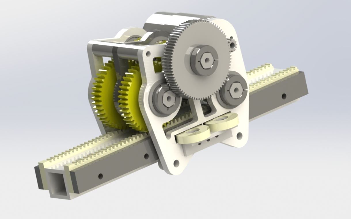

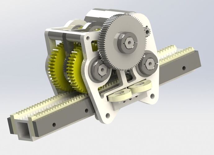

pic: (Looking for feedback) Rack and Pinion Calculations
Hey all, here’s a little project I was working on yesterday. Our team has never really had the chance to work with any sort of linear actuator before (with the exception of pistions, we love those), so I thought it would be cool to try and prototype one. It’s a rack and pinion driven by a 775pro on a 7.3:1 gear ratio, using a 10-inch rack with a 20dp tooth profile and 44t pinion gear. The rack (because of my team’s machining capability) would have to be either outsourced or laser cut from delrin or some other plastic. Does anyone have feedback on how I can improve this design?
Also, I was wondering how to do calculations for a rack and pinion mechanism. Given the gear ratio and the 775pro’s specs, how much could I expect something like this to lift (assuming the delrin rack doesn’t shear)? Could I have chosen a better motor for this task? Just looking for general feedback about any part of this design.
Thanks, and have a great day!

Fancy-looking design. Do you have an encoder anywhere on there? Also, is the center plate really necessary?

If all 3 plates have bearings for your shafts, I would recommend getting rid of the middle plate or at least the bearings if there some on the shafts. 3 bearings too close together on the same shaft overconstrains your geometry and can lead to inefficiencies and unnecessary additional loads on your bearings. So you get a lighter weight and possible more efficient solution? That seems like a win-win.
I see you have bearings running on the bottom edge of the box tube to prevent the gear from moving away from the rack. Do you have anything to prevent the gears from moving closer to the rack, like a bearing on the top surface of the box tube as pictured?
A few things.
First, you can replace all those shaft collars with a screw and washer. You’re already using ThunderHex, which has a hole specifically designed to be tapped for a 1/4"-20 bolt. Tap the ends of that hole, and put a bolt and washer on each side, and you will be able to constrain everything on the shaft without the large, heavy, and cumbersome shaft collar.
Second, if you’re looking to optimize for a certain speed or current draw, you should take a look at my design spreadsheet here. Specifically, the MechanismRatio tab. By selecting the motor (775pro), voltage applied (12 probably), radius (last gear pitch diameter = #teeth*dp), and load you want to lift, it will tell you immediately a few things. If you want to run the motor at max power or max efficiency, it will tell you the gear ratios needed for that. More likely you want to be somewhere between them. So you can specify the adjusted linear speed or current draw that you want, and it will also tell you the gear ratios for those. This should help you actually select the proper gear ratio for your application, rather than just selecting gears and then seeing its speed and how much weight it can hold.
Third, if you are planning on using plastic racks with metal pinions, you may find that your racks are degrading faster than normal. With such a big difference in hardness, the pinion will probably start to wear into the rack over time. You should look into buying metal racks (20dp, 14.5pa) from McMaster if you want a more sturdy solution.
Also, I’m a little confused on how the side bearings are being attached. Can you provide a description or a better of that so we can give feedback.

Thanks! There’s no encoder (I was too lazy to add one) and no, the center plate isn’t super necessary. It was just there for a bit of extra support, since I figured there would be a bit of flex between the two outer plates. It could be gotten rid of, though.

That’s a really neat solution to constraining things to shafts! I figure it probably only works when things are on the end of the shaft (if something was in the middle, you’d till need to have a collar or C-Clip).
I aso, didn’t know that people sold metal racks, I’ll be sure to check those out.
The side bearings are attached via bolts through them to a piece of L-stock riveted to the side of the side-plate. they have ABS or Delrin (some other material may be better, idk) “wheels” around their outer races, in order to get their OD’s big wide enough to contact the ABS buffer on the side of the tube.

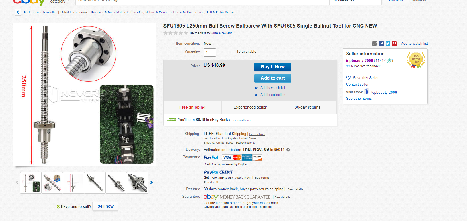

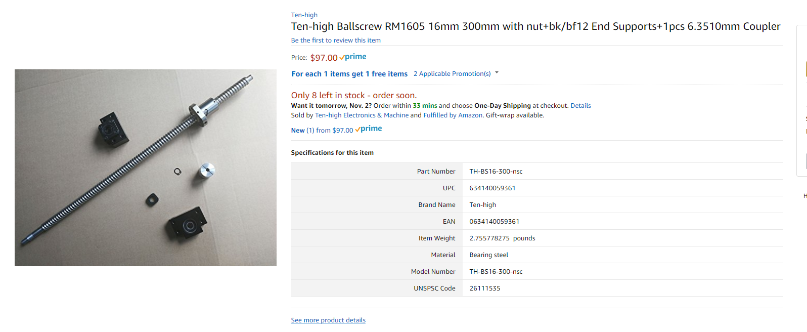

Adding onto this, an imported ballscrew bought in the USA can be quite cheap if you are worried about efficiency or speed. From Amazon for $97 you can get a ~12" ballscrew with nut and bearings. Without the bearings the price goes down to $37.
From ebay a 250mm screw is available for $19 without bearing blocks, which run around $20 for the fixed and floating bearing block with all hardware.
PS sorry for making huge images, I couldn’t find an easy way to resize them.
