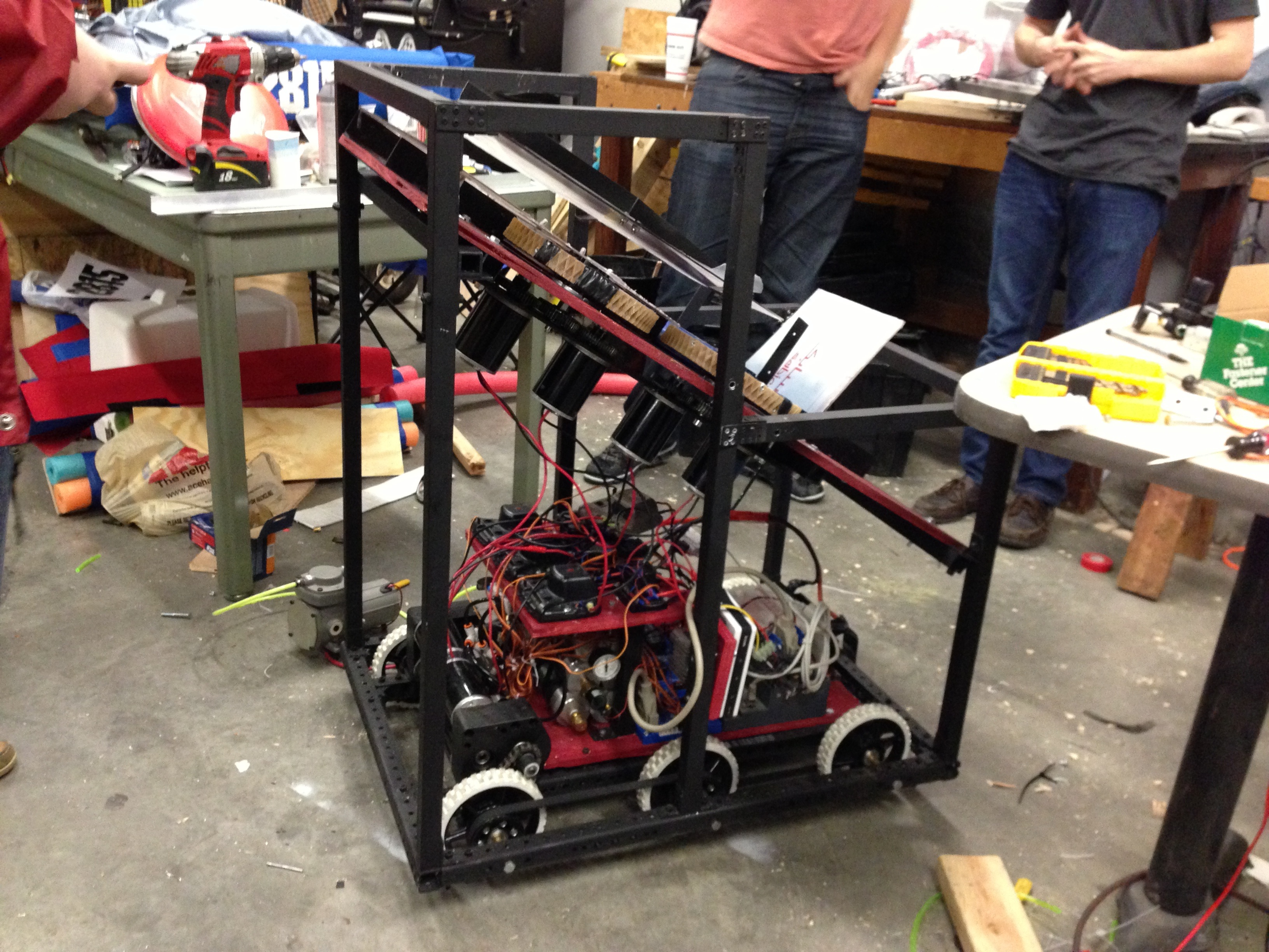

Here it is, as of 11:20 PM last night within ten minutes of bagging. Some specs:
*VexPro 2-speeds, 4 CIMs, about 15/7 FPS.
*Kitbot-derived 6WD setup, with four long belts for power transmission. We had trepidations, but this choice probably saved us hours of fussing with chain. The only chain we used was between the gearbox and rear wheels to get the reduction we desired.
*Yes, those are four Mini-CIMs on the shooter, fed through our first custom gearbox since 2010 (and the first one I’ve really been involved in designing in all ten of my seasons across three teams). It took a couple of weeks to dial in, but it’s sweet.
*Shooter wheels are 8" FIRST Wheels skinned and wedgetopped. We have the ability to adjust frisbee squish. (The electrical tape is to reduce the chance of a wild belt end catching something and causing more damage.)
*Passive hanger, tested at home and awaiting paint and a little CoG adjustment. Hey, we have to do SOMETHING with the withholding allowance…
Look for us to defend our back-to-back Palmetto Regional titles next week, then our first trip South Florida, then if the planets align Championship, then if the planets REALLY align IRI, and then SCRIW. :slight_smile:

We’ve got it geared for a smidge faster linear speed than the RI3D shooter; going to four allows us to spin back up faster and worry far less about current draw. This was more of a concern when we were looking hard at pneumatic wheels, but the headroom is still nice to eliminate any inefficiencies inherent to the design and assembly process.
Could we gear it faster still? Probably. Will every single member of the team that put this robot together kill me if I called for tearing down that gearbox to rebuild it with new plates? Definitely.
We know we can hit from most of that end of the field, but we’ll get better data next Thursday. For all the many things the University of South Carolina supports us with, room to uncork this thing is not really one of them.

Un-tempting! To anyone thinking “Hey, this gearbox designing business looks easy!”, start with an arm! Starting out with a gearbox built for speed (meaning misalignment and friction are more of a big deal) and turned on its side (meaning thrust loads are significantly more of a concern) is a recipe for frustration, headache, and words unfit for ChiefDelphi.
We actually painted this robot twice; the first job was a little premature and suffered through some reengineering and disassembly. The paint job is pure rattle-can spray paint, done just outside our shop with a little primer underneath. We probably have about $30-40 invested in it, but to me it makes a world of difference. Incocknito last year wouldn’t have been half as imposing in bare metal and wood.
(And wood-bot haters beware, everything garnet in that picture is 1/2" birch plywood. It’s not what you use, it’s how you use it.)
