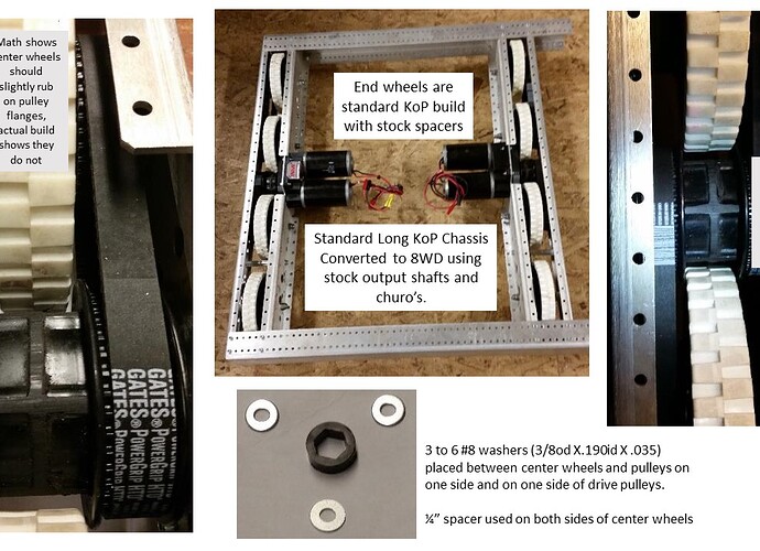

pic: Modified AM14U3 8WD Build
Built a modified 8wd version of the AM14U3 without using all of the parts from the kit. Which retains the stock output shafts and churo’s. I’ve had this completed for 2 weeks now, just late getting it uploaded.
This is great! We love it when teams make the AM14U3 their own.
