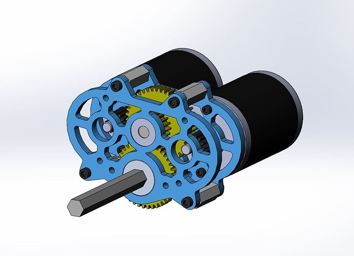

Hi everyone! This is an example gearbox that I created for next year’s training program, but I’m not sure if its a good example (I’ve never modeled a gearbox before). Does anyone see anything that should be changed?
It’s a one-speed gearbox that has a roughly 8.5 gearing ratio, (for games like recycle rush or whatever that don’t need high speeds) and the drive motors are 2 Mini-CIMs. The front plate and back plate are identical for the sake of simplicity.
Cheers!
Looks good as far as I can see. You are probably going to want to add some retaining clips for the Mini Cim gears, though.
Sorry for another reply, I cant edit posts yet. But, another thing is some of those internal angles on the face plate, especially near the bearing. They look too sharp to be machinable with any decent sized endmill. Consider throwing some larger radius fillets on those spots.
Thanks, I actually noticed that too. I was planning on adding another set of fillets there, but forgot. heh.
Also, if you don’t have them already, make sure to add holes for mounting the gearbox onto some sort of frame. It might be a good exercise to do them for a KOP or some sort of standard frame.
It has a set of clearance holes for a wcp bearing block kit (from vex) on either side of the bearing. This gives it one attachment point to the frame via the bearing block, which I think should be enough. I was considering adding another set of mounting hole, though, as I’ve had experiences with gearboxes sagging towards the center as the season progresses.
It’s usually a good idea to have a separate set of mounting holes for the gearbox alongside those on the WCP bearing block (from WCP) to help take the load of the gearbox weight, so that way the bearing block isn’t supporting the entire load of the gearbox.
A good example of this is the WCP DS transmission - check it out if you get the chance!
From experience, it is somewhat iffy to use the bolts holding the gearbox together as an additional attachment point - tightening them enough to provide significant support tends to bind up the gearbox.
That’s why you have rock-solid spacers between the plates and don’t overtighten everything. Some forethought and moderation can go a long way in design :).

Kaorin, your design is pretty rock solid for a first time custom gearbox - nice! A helpful trick I learned from using the WCP SS is to use at least one set of your CIM mounting bolts to hold your gearbox plates together. Just run a standoff between the plates and thread a bolt long enough to get through both plates and the standoff into the motor and you can get a pretty great connection while utilizing already-existing geometry! You also don’t need to use hex shaft for standoffs unless you’re planning on threading into the shaft and need to tighten it down - round standoffs will do in this case!
