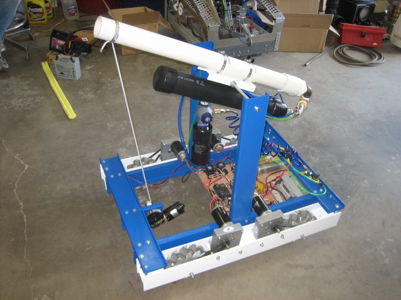

Getting back to the model and your questions/concerns about the motor mounts, could you add a closer picture from a better angle of that area? Perhaps you could hide/blank the omni wheel and wheel shroud…
…and by the way, that’s a really cool looking chassis design!

I do like this chassis, it looks very open, nice to work on.
