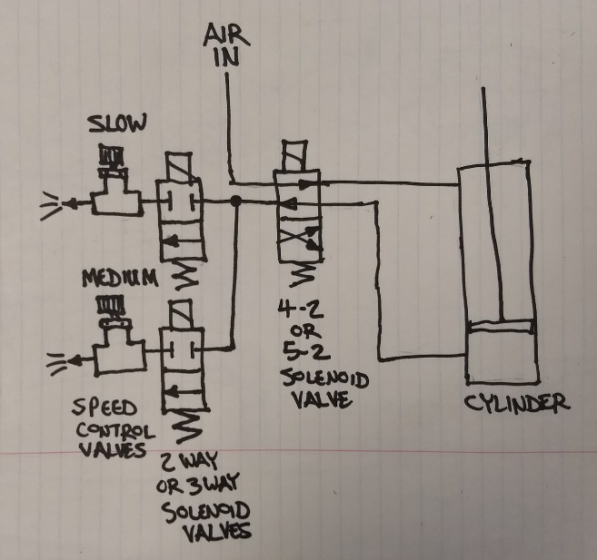

Electronic speed control valves are available from ProportionAir, Festo and SMC, but they are very expensive - probably over the maximum COTS part price allowed by FIRST.
Here’s a somewhat crude way to electronically control the speed of your cylinder. One throttle valve is adjusted to “slow” speed; the other is “medium”. If both solenoid valves are opened, you get “fast”. This gives 3 speeds. Add more valves to get more speed choices.
Please ignore the backwards arrow on the bottom of the 4/2 solenoid valve. :wink:
Yep, that’s a legit way of controlling speed. However, Pneumatic rules change. We used to be able to use two solenoids in series to control the extension of a cylinder. A few years ago, they ruled that such configurations were illegal. Please, check your game manual before trying to use this on a next year’s robot.

I think the only applicable rules this past year were R94A and R95. Basically, you cannot plumb multiple solenoid outputs into one line, and you can’t have any setup that prevents all of the pressurized air from escaping when the manual relief valve is opened. I think the layout posted above would actually have been allowed. (link to rules)](https://firstfrc.blob.core.windows.net/frc2017/Manual/Sections/08-Robot.pdf)

I’m not going to argue legality. Couldn’t you do this with two valves? Replace the two 2-way valves with a 4-way with your flow controls on the AB ports. Less plumbing, less wiring, less software.
The schematic posted allows 3 speeds, slow, medium and fast (slow+medium). Your suggestion would simplify things, but would only allow 2 speeds.
I agree that R95 applies here. However, I can think of at least one way this can be accomplished with a legal implementation.
By “applies” do you mean that R95 makes this illegal? If so, how do you figure that? The only plumbing which connects multiple solenoids connects one exhaust to two inputs. Even considering the exhaust as an output (which I would for purposes of this rule), in no volume between the valves are multiple outputs plumbed together.
The rule was intended to keep teams from increasing the flow rate to a single Cylinder. This setup violates the spirit of that rule, if not the word.

Sorry? The sketched setup does control the exhaust. The outputs of no two solenoids are plumbed together. R95 does not “apply.”

The design above reduces the flow to the cylinder (by reducing the exhaust flow).
The largest flow to the cylinder can be achieved by letting the air out through the exhaust without any throttling or silencing (for a given supply capacity).

I would argue that R95 was not violated because nowhere are the outputs of multiple valves plumbed together. So the letter of the rule is not violated. The intent of the rule is to circumvent the flow restriction of the valves by using multiple valves in parallel. Since the circuit already has the entire flow through one valve, the intent of the rule is not violated either.
