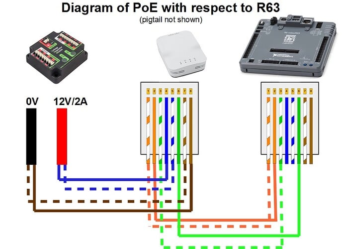

pic: Power Over Ethernet for 2017
This diagram explains how to create a custom wire to power the OM5P-AC and OM5P-AN through the 18-24V Ethernet port while compiling with R63.

Thanks for this, but a few questions.
  1. Will any inspectors not understand this and fail it because they have never seen it? I know that impossible for people to answer but whats your opinion.
  2. How reliable is this for vibration? I know last year was a tough game for robots and many people has the radio power fail them, but is this any better? If seems like it would be but do people know for sure?
  3. I assume you have to make up your own custom cable by using an RJ-45 end and then just running the conductors where they need to go?
Thanks
  1. Definitely bring along a diagram with you to explain to your inspectors what this is.
  2. I didn’t have experience with it personally, but I heard lots of anecdotal evidence that this was the go-to solution for vibration-related radio power issues for many teams last season.
  3. Yup. It’s essentially making a custom/more compact version of one of these cables: Passive PoE Injector Cable Set : ID 435 : $5.95 : Adafruit Industries, Unique & fun DIY electronics and kits. There are several available on Amazon as well, if you want to avoid making your own cable.

I’m assuming you mean run a separate cable for the barrel jack and not trying to plug in both the Ethernet pigtail and the barrel jack from one of the Adafruit cables into the radio right?
Just so it’s clear to others, that would not result in powering the “PoE” port on the radio as the Ethernet pigtails on those cables do not have power on the pins, the Ethernet cable you connect to the female Ethernet jack on the cable does.
We are planning on using a passive injector similar to these: https://smile.amazon.com/gp/aw/d/B00S5ROQO6/ref=mp_s_a_1_38?ie=UTF8&qid=1486479541&sr=8-38&pi=AC_SX236_SY340_QL65&keywords=passive+poe
We will be removing the barrel plug and soldering in a whip that can plug directly into the VRM.
Note passive poe injectors are explicitly allowed per the blue box of R51. So as long as you can explain I would find it hard to fail inspection.
The advantage of using something like the one I linked is the reduction of single point failures. There’s only one cable plugging into the radio (not an Ethernet cable AND a barrel plug). This is at a cost of a single additional RJ45 connection and the loss of a barrel jack connection (which is the one that usually fails you since there is no positive retention. With the previously linked cables, you’re reducing the wires that need to run across the robot, but you have increased the number of failure points as there are two additional RJ45 plugs and one additional barrel jack connection. So reliability has actually gone down.

Yes I mean running a separate power cable for the barrel jack, and they are both powered off the VRM. You will know you did it correctly when you can unplug the barrel jack or the Ethernet cable and the radio still maintains power as long as one of them is still connected.

How do you comply with wire gauge restrictions when doing this? Most ethernet cables are 23-26 ga. (usually 24) but 22 ga. is required in the manual for 12v 2a. Would it be legal to crimp 24ga (either from an ethernet cable or individual) wire into the RJ connector then solder the +v pair to a 22ga wire heading to the VRM and the same for the ground?

You can’t actually use that injector in the configuration you were thinking of.
Power is only injected into the female end, not the male end.
This is the picture I posted of my setup when I talked about it: https://www.chiefdelphi.com/forums/attachment.php?attachmentid=21527&d=1484316250
22awg =0.326 mm^2
The passive power injectors use pairs of conductors for sending power and ground (a total of four conductors used).
24awg = 0.205 mm^2
So you effectively you have 0.410 mm^2 cross sectional area of copper which exceeds the 22awg requirement.
At least that’s how I was planning on explaining it away if the question came up.
