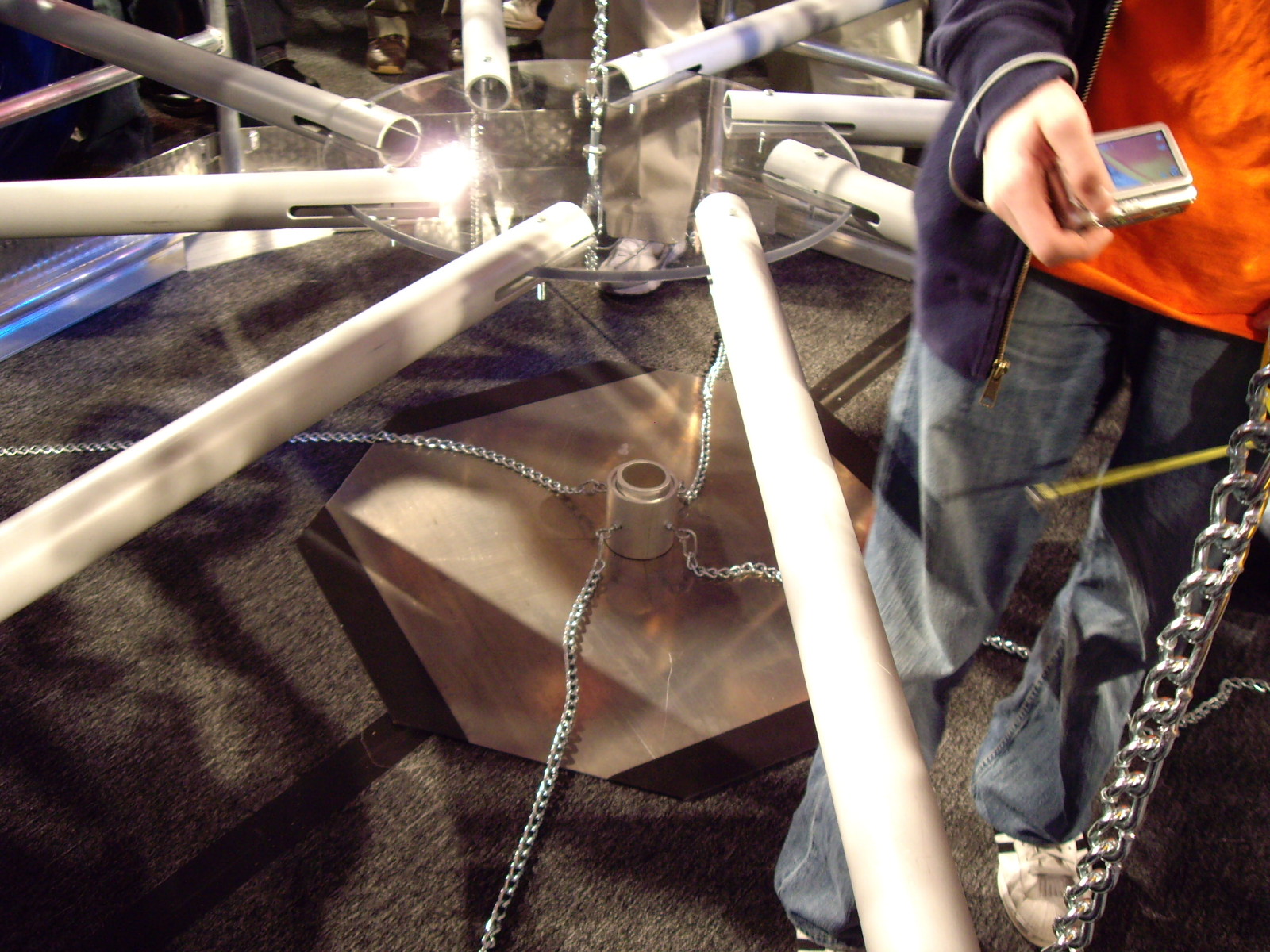

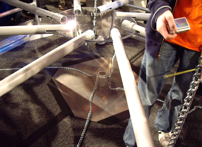

Here is the chain base for the official fields. It allows the rack to rotate, and translate up to 1ft in any direction. Keep in mind the rack is metal and PVC, so theres a good amount of friction force to overcome in order to move it
