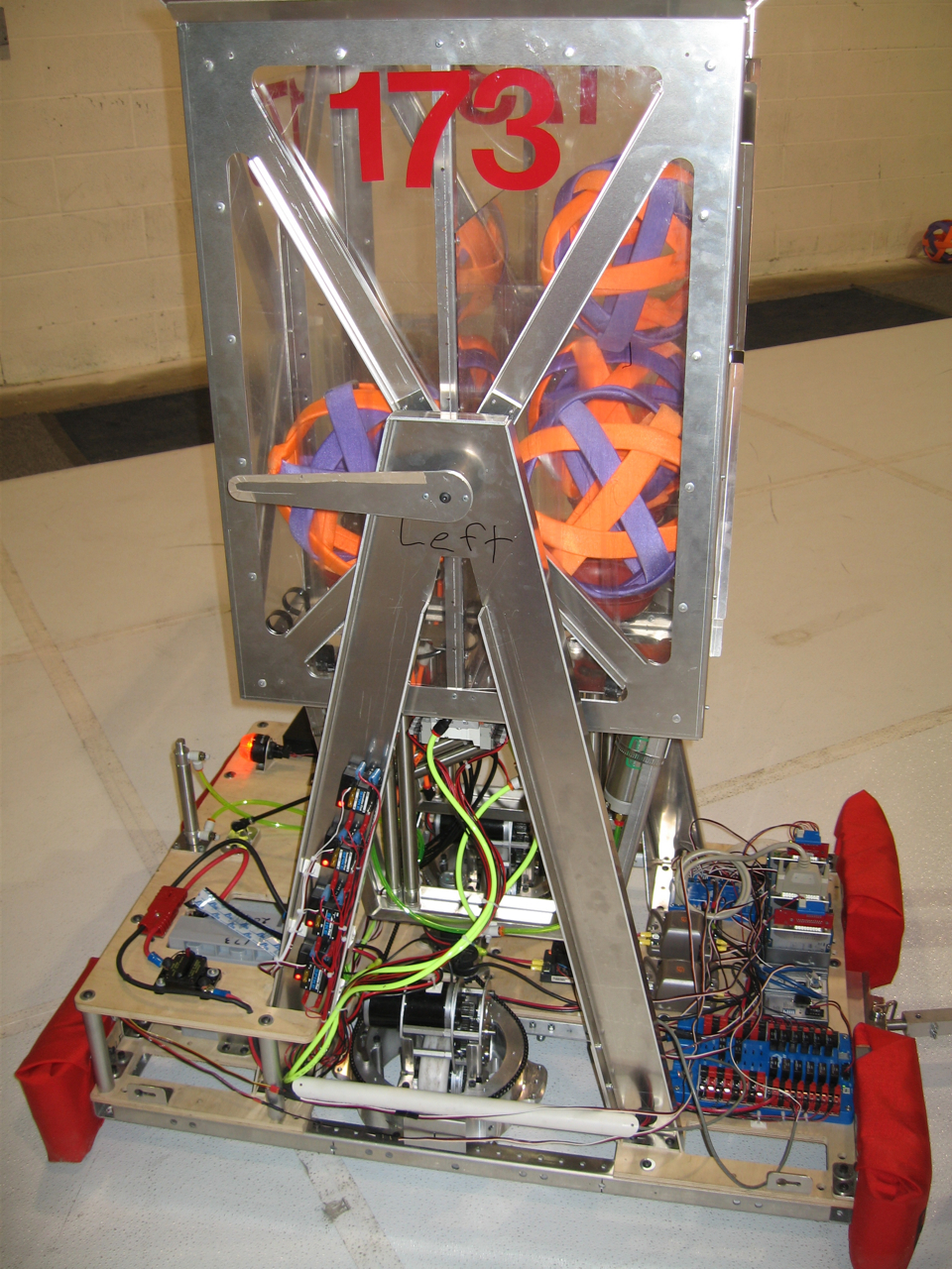

Here’s our 2009 robot. Yup, we’re anonymous teaser #2. Kudos to sdcantrell56 for guessing correctly in the third post.
Sorry no plywood frame this year. :frowning:
This show’s what the other picture didn’t though. Two wheel swerve drive.
The bot holds 12 balls and forces them all out in about a second with pneumatics. The entire basket pivots forward and back to give us a better angle to score and human load. Yes, it stays within the envelope when pivoted.
There is also a space in the front to capture one ball (empty or super cell) and deliver it to the Payload Specialist.
