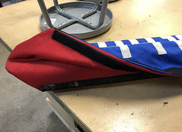

pic: Reversible Bumpers
An example of our Reversible Bumper design. Switch from Red Alliance to Blue Alliance without removing the bumpers from your robot.
A word of caution: check the bumper rules very carefully, specifically R27. We’ve always used color-matched velcro to avoid issues with how that rule is interpreted.

We made these last year and they were really great. If you have the velcro fold over behind the bumpers and attach there, then it’ll just be red or blue that is visible. We did that with black Velcro and had no inspection issues, but YMMV.

You mean R27B, which happens to include an exception to the color rules for Velcro/snaps on the wood backing?
We learned quickly to have an elastic loop through the flap set so that if the velcro let go from vigorous robot interaction the elastic will pull all the flaps back in place. I think we’ve have reversible bumpers since 2012 and we’ve dealt with all sorts of hiccoughs related to them.
