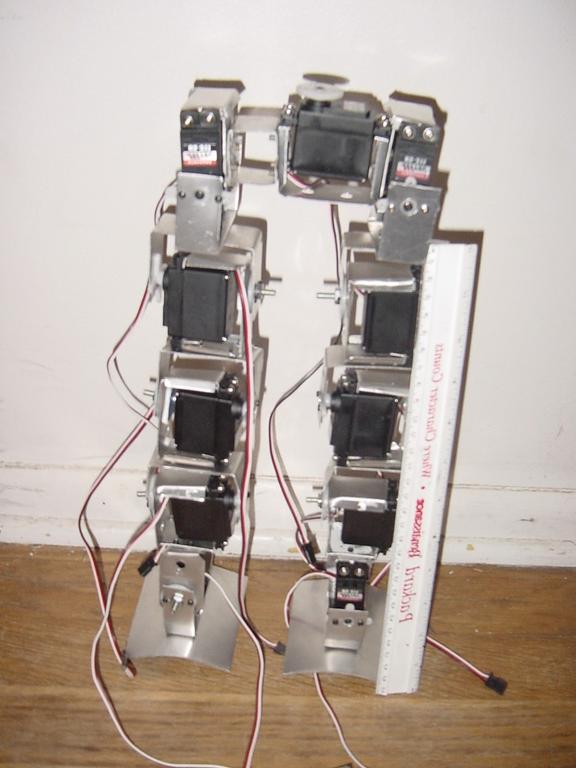

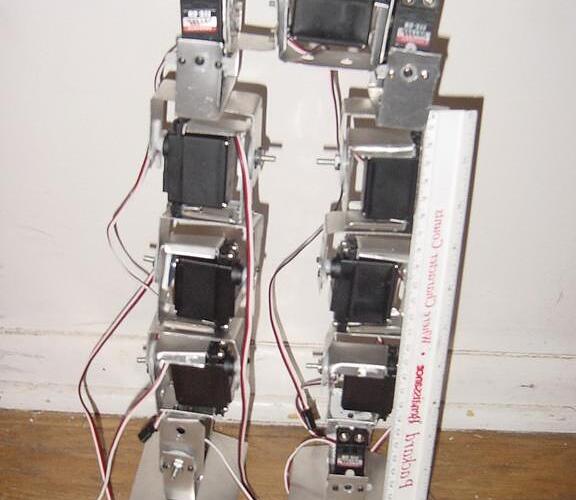

pic: Robo-one legs
We'll I finally made it to the halfway mark on the construction of my robot. These are just the legs and already it's over a foot tall. It may look a bit crude and unstable but actually it's quite sturdy (my cat already tried to play with it). It's made out of HS-311 servos, .030 aluminum and a lot of screws. I started making it with my MAX NC 3 axis cnc mill but I ended up just using a pair of tin snips and some elbow grease.

In the picture you are using 11 servos… if you are adding a body with arm and a head, you would add atleast another 5 servos. How are you planning on powering 16 servos to work the same. What kind of controllers would you use and why? Do you think you will need more than one controller? what kind of battery are you going to use? Don’t you think it will weigh a lot which may cause it to tip over?

Cool. I tried something like that once (but w/ Lego’s, needless to say, it never really “worked”, per say). Have you given it a test yet and will it have a gyro sensor to detect and compensate for balance? It really want to see this thing walk! :smiley:

We’ll I’ve already tested it and it walks fine. I’m using a lynxmotion BASIC atom pro 24 pin module and their mini Atom bot board. I’m going to have to purchase their servo controller though because I need to control (ready for this) 19 servos. I didn’t really design it to walk up stairs but it can. And I’m not using any gyros (yet), it just takes about 400,000,000,000,000,000 tries before I get the servo placements and timings right so it doesn’t fall over. I plan on putting up a video of it walking, but first I have to program it. If you plan on building something like this DON"T but the BASIC atom pro + bot board, it can control 20 servos, but only 1 at a time. So lets say i want the legs to crouch and both motors need to move an equivalent of lets say 800, I have to divide it by a big number and then move each one back and forth.

O, and for the batteries, I’m just using a 9 volt battery because the BASIC atom board can take up to 9 volts and convert it to 5 volts for the micro controller and the servos.

I’m having trouble with the programming though, if anyone knows how to put voltage through a pin in order to keep a servo from moving, or if you know how to make more than one servo move at a tine, OR if you know how to sue the pulsout command, please help!!
you tell the servo the angle you want it the potentiometer inside it will keep it at that angle and as long as power runs to the servo it will “lock” it at that angle. i recomend Robot DNA building Robot Drive Trains. its a must.
i did a sumo bot that ran on servos. keep in mind if the servos aren’t quite up to the job you can get more power from the motors by giving them more juice than their rated for. note that this is actually safe as long as your careful. you can run a servo on up to 12 volts but the motor will get warm pretty fast and i would not recommend running them more than 4-6 min on a high voltage (and yes this will lower the milege of your motors but the speed and power increase is worth it).

I think that’s a lot of load for those servos to handle at the top, but it does look like it will be cool once it gets moving. It will never outrun anything with wheels, but it definitely scores in the articulation category.
yeah I’d like to see a wheeled robot do a back flip, lol. But if you could provide any code examples it would be nice. I’m not much of a programmer.
sanddrag makes a valid point but i think you are going to see more motor problems at the bottom. if you can run different amounts of current to different motors run about 8 volts to the bottom motors.
I figured out one major problem with the legs, i need to take out one servo from each leg, not only will this make it more stable, it’ll make it easier to program.
I think 8v is far too high for most hobby servos. I think about 6v is the max.
I was beginning to wonder why you had some many servos. You should only need 3 per leg (just like human legs) including ankles. It would definatly make things easier.
