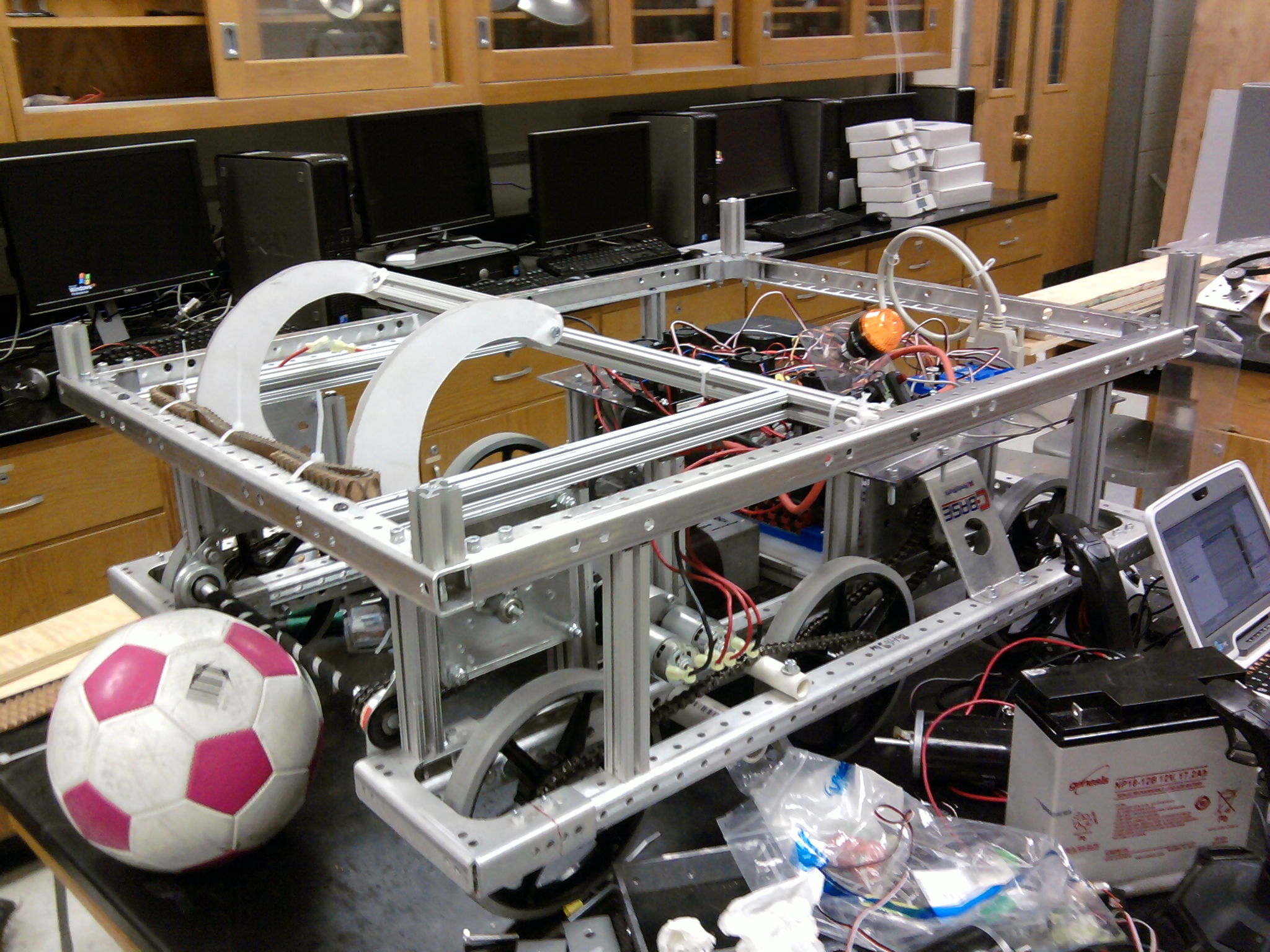

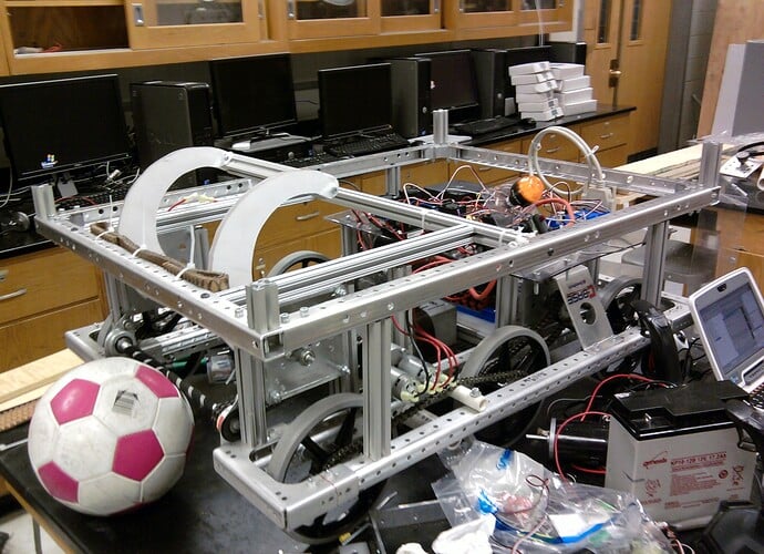

Central High’s RoboLancers 2010 robot as of 11pm on 2/22/10.
Specs:
6wd Powered by 4 CIMS: 4 x 8" “Sticky” Wheels + 2 x 8" AM Omnis (Not Pictured). Climbs and tunnels.
Kicker: 9" arc striker powered by an AM toughbox with 1 CIM. Range: 0’-18’(Variable).
Roller: 1/2" Aluminum shaft powered by the AM Double Doozy
Not pictured in photo includes: lexan guard top, graphics and bumpers.
