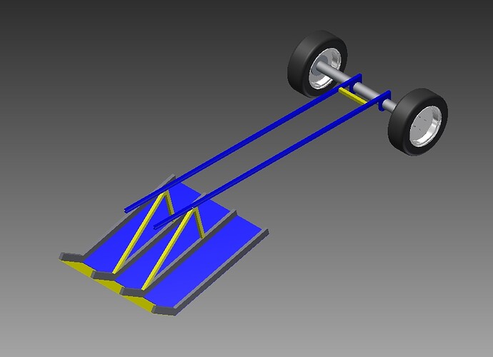

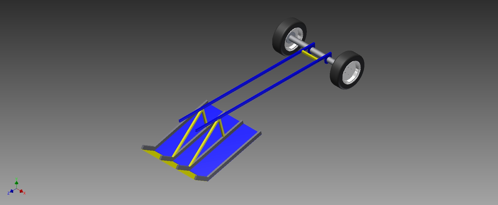

pic: Robot Pull Boat
You have seen tractor pulls, truck pulls, lawn mower pulls ive even seen tricycle pulls but now a robot pull? This is my first crack at my robot pull boat took around 24 hours to concept and cad this first draft
Would you build a robot to compete in a pull?
cool idea and id love to see it done. but i think you need to look at plans for a pedal tractor sled.
start with an axle you have like a lawn mower or atv!!
our robot did a pedal tractor pull and had no problem with like 160lbs in the box
__
Tractor pull sleds have a mechanism that makes them progressively harder to pull over distance.
The mechanism isn’t on the design, The weight box will mount on the 2 I beams.
