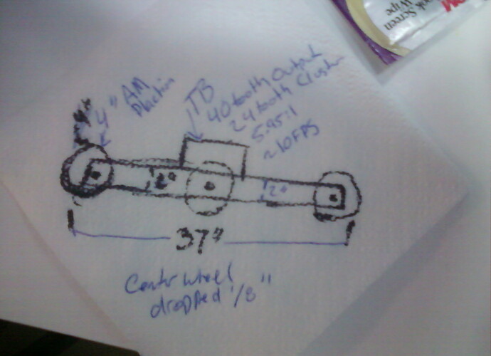

pic: Schreiber Take on West Coast Drive
Quick napkin sketch of a drive system I figured I would share since everyone and their brother seems to be posting these new fangled west coast drives. Weight estimate ~27lbs (no electronics)
Direct drive the middle wheel (dropped 1/8") from the toughbox. The TB has the optional 40 tooth output and 24 tooth cluster gears for a total reduction of 5.97 and a rough top speed of 10fps when using 4" plaction wheels. The outer wheels are dead axle and chained to the center wheel. Chain will be tensioned via AM Chain Tensioners.
Ok, now that you read all that you get to read why I did this. You don’t need fancy renders, in fact, they are a crutch. In the time you spend figuring out how to make it render pretty you could have figured out the correct ratios to make the robot drive properly or how to route your chain. I think I speak for any mentor when I say that I would rather see that you guys figured out how to properly calculate what sort of reduction you need rather than see that you figured out how to click the “make it pretty” button.
(And yes, I did actually figure out a rough weight based on my materials!)

Have you preformed stress analysis on that frame?
Very concise drawing. Lacks a little finesse, maybe try cardstock later. :stuck_out_tongue:
Just a quick question, in this layout, is the chaining going on the outside of the chassis or on the inside?
Some of our team members like to call it NCAD (Not Computer Aided Design)
With dead axles, I would assume that the chain would run on the same side as the wheels (outside).

The funny thing here is that while you’re preaching to us how doing the math is better than a pretty render, I think your drivetrain won’t perform adequately with the gearing you’ve outlined. 10 fps with 4 CIMs isn’t the best acceleration, and you are nowhere close to traction limited. Pushing matches will probably trip your breaker faster than I would be comfortable with. Your gearing would probably eat through batteries faster than I would want as well. You could increase your reduction a bit to become traction limited at much more feasible currents, while increasing your acceleration enough to virtually make up for the speed loss in a Breakaway like field.
This is assuming you bring your robot to full weight. At the 27 pounds pictured, I bet you would have zero problems. :slight_smile:
Chris, the two speed sketch is on the reverse side of the napkin, you can’t see it

Specifically, what part of my math did I do wrong? (Remember folks, I am a programmer, I do this in my spare time) I worked out what the speed of the motor at 40 amps was and based the speed off that. Is a 5.97:1 reduction too little for a 4" wheel?
Well I suppose one probably could still design it, but like you said, it’s probably not an elegant solution.
I think your powertrain calcs are probably fine, and I wouldn’t worry too much about acceleration. My freshman year (2001) we ran 2 Bosch drill motors geared for 10ft/s and it worked wonderfully, 4 cims should have plenty of torque to get you by. You probably won’t win a pushing match against a hardcore pushing robot, but that’s what shifting transmissions are for if you chose to use them.
