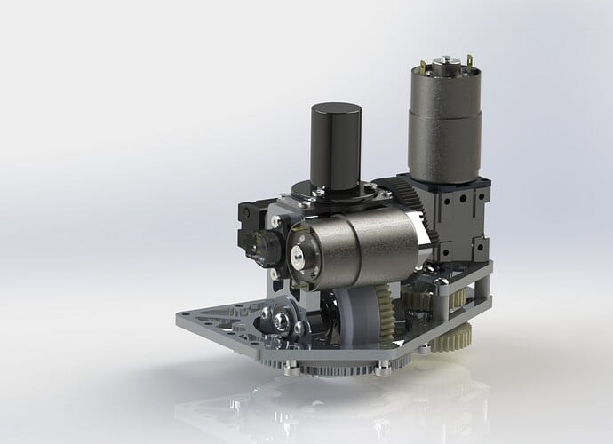

This is a swerve drive design I have been working on recently. It’s inspired by Bomb Squad’s swerve as well as some designs by Bryce2471. It has a 17.33:1 gear ratio for a free speed of 14.14 ft/s. The rotation is powered with a 775pro with a 52.86:1 reduction.

Hey man, that’s a pretty sweet design!! What’s the black …thing… on top of the wheel sticking vertically up? I can’t see an obvious purpose for it.
#3
That’s the slip ring, not showing the wires.
I agree it is a pretty cool design. Very low ground clearance, so maybe not for every game.
I also think it is geared aggressively. 17.33 from the 775pro to a three inch Colson puts the slip current (on FRC carpet) a little over 60 Ampere, so you are traction limited on the “wrong” side of peak power. No real issue as long as you stay out of shoving matches, with other robots or with a barrier.
#4
Would you mind expanding on being traction limited in the “wrong” side of peak power?
#5
Couple of questions:
Why the 775 for steering? With the drive motor on the turret, there will not be any reaction torque back into the steering motor from the drive torque. So it seems like you could easily reduce the size, weight and cost of the module by switching to a smaller motor like an RS550.
What slip ring are you using? How many wires and what rating per wire? What are your wire allocations?
The most appropriate slip ring we have been able to find is a 6 wire with 30 amps per wire rating. But this slip ring would not allow you to send full power to the drive motor without using 2 wires to feed power and 2 wires for power ground return. This leaves only 2 wires for a wheel speed encoder. However, if you limit the motor power to 30 amps in the motor controller, then you would still have 4 wires available for the encoder.
#6
I think that’s a Talon downstream of the slip ring. Looks like the plan is to pass CAN through the slip ring. 2 for power, 2 for ground, 2 for CAN.
RS550 would be a better choice for azimuth IMO.

I have never seen heaven and hell in one picture. Great design.
#14
Thank you! And yup, that’s the slip ring.
The 775pro is used for steering mostly due to my unfamiliarity with swerve. I know the 775pro is overkill for this application though. If this is built, I plan to run the 775pro below 12v. It should help reduce thermal buildup compared to an RS550. It is a VP though, so it’s easily changeable to an RS550 if wanted.
The slip ring I found is also a 6 wire rated at 30 amps per wire. I suspect it’s the same one you found. There is a Talon SRX on the module though, so CAN can be used to read the encoder data. This leaves 4 wires for the motor.
The CAN topology is relatively flexible. I believe that 16’s setup was similar in that they ran CAN through their slip ring. It is possible to use only 2 wires for can using a star topology, for example.

Sweet! The drive rectangle turned out especially well, I really like the packaging you found. Do you have any provision to spring-load it similar to 2767’s positraction?
#20
I’ve been think about this a bit, I wonder if mounting the assembly on a elastomeric damper (like these) would give enough compliance to provide a similar effect with reduced complexity.
