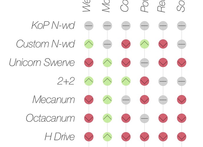

pic: Subjective Eval of Common Drive Systems
A simple subjective evaluation I decided to toss together as both an example of how folks could represent design choices as well as to help students evaluate options or at least provide a jumping off point for research.

I’m not sure how your defining power. I’d argue that it’s pretty independent from drive train type (except if your accounting for efficiency losses).
For example, you have 2+2 listed as low power. Our 2014 bot had 6 CIMs, which most would argue is plenty (or more) power than you need.
I confess, I’m not at all a fan of 2+2. The turning center is nowhere near the center of the robot, which makes maneuvering very strange. It also has a nasty tendency to fishtail. Calling it “more mobile” than a standard 6wd is…a bit of a stretch.
Not sure but I am guessing something like pushing power. All other factors equal. Maybe
KoP drive gets dinged on complexity? That thing can get done in a couple of days if not within a few hours. Have any Kitbots really broken yet?
I doubt it they are extremely tough
I like this - it’s a nice visual guide for those who would be confused by a weighted cost/benefit table.
My only question is what examples did you use as a baseline for this? Of course it’s subjective, so this is all based on a team ability/skillset/resource capability that you had in mind, so it would be interesting to have that information on the graphic for context.
I think you’re reading it wrong. KoP isn’t getting dinged on anything.

This is nice for those who wouldn’t understand a weighted cost-benefit table. However, I don’t believe it’s a very good substitute for it at all.
First off, it lacks granularity and makes certain drivetrain types seem better than others from a numerical standpoint when they really aren’t. Parallel Omnis seems like a great choice for a drivetrain on paper, better than tank drive (hint: it really isn’t. I like different drivetrain designs, but go with a 2 x 2 or butterfly or something if you want better turning).
Speaking of tank drive, KOP isn’t really the baseline you want it to be. Any decent custom tank drive is more reliable than the KOP chassis, has more pushing power, and more mobility.
To properly explain drivetrain design, it’s best to come up with a long-winded post on why tank drive is the best and you should never use anything but tank drive (that’s not really what I believe, but it’ll go over well on CD). Explain that every single drivetrain other than tank will break down by the end of every match or be so complex that you wouldn’t get done with it by the end of build season (again, sarcasm intended, but this is how CD feels).
Seriously though, best way to explain drivetrains is to justify your claims.

This is correct, the KoP is my baseline for everything. From there each attribute is graded as either better, worse, or equal.
I was more working from staying power which is where it gets dinged because it can be more easily spun.
You’re right, this doesn’t replace a good WOT or a good discussion. However, one of the goals was to distill a design/prototyping process to something that can be seen at a glance. Things like this are useful for showing to judges or as documentation.
KoP is a baseline because it’s about the only thing every single team can see the performance of. It’s a baseline precisely to get everyone on the same page.
I’m not sure if you’re quite reading this chart properly. On paper Asteroid Drive (I’m trying Nate!) is about equal to the KoP drive, it’s a bit more mobile but has less staying power.
