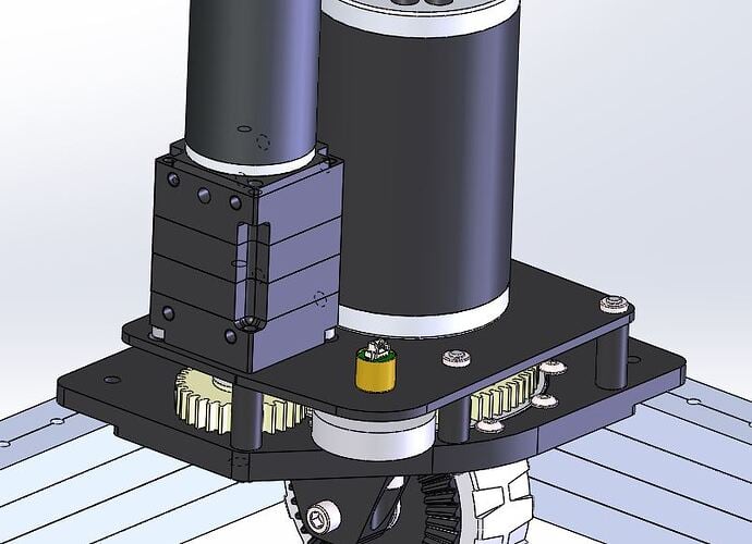

This is a offseason project I worked on much earlier this year, just as a personal CAD project. I wanted to wait until I had 1 real module to post, but Kickoff is creeping up, so I’ll post that when I have one.
While I liked the very compact and Lightweight setup of the CIM in wheel, I didn’t want to deal with the wires ever again, and would rather avoid mercury on the robot (sliprings). This lead to the fun mental exercise of “if I were to make another swerve, what would it be?”
This module is the answer.

Looks great! What is it geared for? I can’t tell from the section view, but it looks like it’s cutting close on the clearance for the wheel. Do you know off hand the amount of clearance it is?
Are there not suitable sliprings for this application which contain no mercury?
A few questions immediately pop up for me:
How is the CIM shaft so short? Isn’t it against last year’s rules to modify motors?
Where would you get the bevel gears, and how much would they cost?
What’s the weight?
Other than that, it looks very good.
From the cut-out in the other picture, I’m having a hard time figuring out how the large turning gear is mated to the grey-ish ring that acts as the weight-bearing thrust bearing for for the entire robot. It seems like all of the robot’s weight is hanging from this ring which is hanging from the gear?

Is the weight of the robot sitting on the cim pinion? I can’t figure out the wheel pivot bushing/bearing for this design.
Edit: I see the button heads now. Is that a silverthin bearing?
It’s compact for sure, but I can’t figure out the bearing design.
As far as I can tell, all of the vertical loads are taken by the CIM shaft (!), and I can’t really tell what takes the horizontal loads. There’s an upper steering bearing on the CIM shaft, but the only lower bearing I can see is the white ring below the steering gear and that doesn’t have much radial contact. What am I missing?

Very nice swerve Aren. It’s cool seeing your drives. Are you using a dead axle? Is it possible to flip the cim?

Just curious, is there any way we can get our hands on the CAD files to take a closer look at the module? I know this may be a stretch but worth a shot too: If a team wanted to build this, would the spec sheet include all the parts that come together to make this?
I don’t think theoretical weights are fair to compare. If the system isn’t made and working, it doesn’t matter how light it is.
I could go design a 4 lb swerve now, no guarantee it will work or hold up. Many of the recent designs posted aren’t robust enough to survive a season (I think Aren’s here would though, as he’s fielded 5+ swerves at this point I think).
