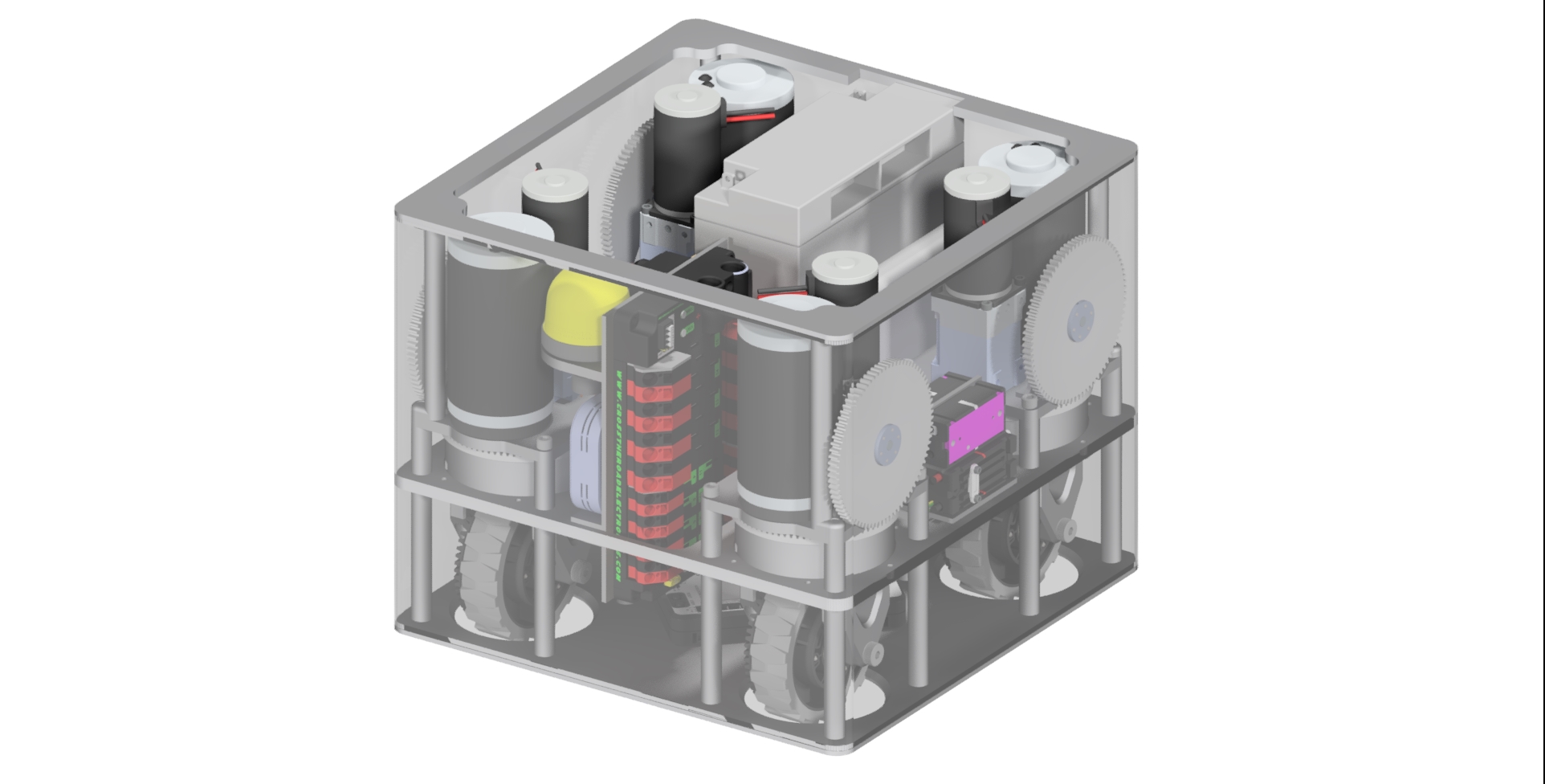

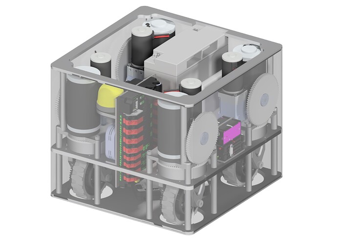

So I finally did it. I was able to fit a swerve drive with full FRC components inside a power cube (13inx13inx11in), What can I say I was bored. This was a daunting task and took quite the time in cad. It currently runs a 64:1 bag motor for steering and a 6:1 CIM for a free speed of 15.5 ft/s an adjusted speed of 12.56 ft/s. I don’t know if it will ever be built, most likely not:(, but if does it will probably be during the fall. Any feedback would be appreciated.

How high is the center of gravity? With the battery and motors that high up, I’d be worried about it popping wheelies and tipping over.
Also, why CIMs instead of MiniCIMs? That change could drop the weight and lower the center of gravity.

Very cool design and packaging. One question: what’s up with those vertical spur gears?

Those are the steering encoder gears. Check out the original module post, which I will note that you posted in :p.
Inventor says it is a bit above the cent of the cube after assigning everything the proper weight values.
I chose CIM because I wanted to have the most POWER. Mini Cims would help to lower COG but not that much as the cube weighs 40-60lbs.
As nickbrickmaster sayed it is to get a 1:1 steering with the absolute encoder.

What’s the ground clearance? Think you could get it up to 3/4"? With a robot that light, 775’s on the drive should be 100% fine.
It is currently 1/4", I might have been to crazy

Why didn’t you use 775 pros instead of Cims? I know they’re not great if you’re stalling them but it seems like they’d manage ok in this application.
Build it using FTC-sized motors for steering the swerve modules, 775’s for powering the wheels and an FTC battery (or two) mounted low down. It might be necessary to limit the voltage to the 775’s so they don’t burn up but with a low power to weight ratio, the drive wheels might just spin.
As for all why not use 775 pro or FTC batteries questions. I did this mostly for fun and if you wanted to slap a 775 pro on here it would be quick design changes or a CIMile. As for the FTC batteries I wanted to use full FRC electronics and the battery was one of the biggest challenges.
Each alliance has a power cube bot that starts in their opponent’s cube pyramid (middle of the base 3 cubes). Playing the Lv3 Force power up activates your alliance’s cube bot, which one of your technicians can control from their seat. Robots cannot manipulate this cube bot.
Have one of the Technicians on each alliance drive one with covers the same color as their bumpers. If the opposing alliance’s powered cube is scored in your vault, it is worth 3 regular cubes (or 6 or 9). If you climb with your opponent’s powered cube, the points for that climb is doubled.
A lot of people have also said why not use this for off season events as extras. Doing some quick guesstimation if you want to run swerve with FRC electronics that will run you $3,000 to $4,000 per power cube with electronics (Rio, PDP, VRM, NavX, Motor Controllers, Battery) being most of the price.
Now there might be a very slight chance I get to build this, or a singular module in Preseason. There is still a low chance because of my teams fear of swiveling drives due to my teams pneumatic turning crab drive from 2010.
