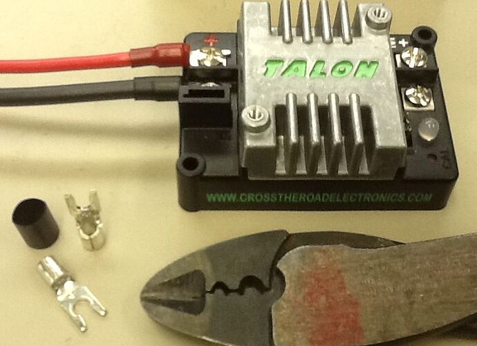

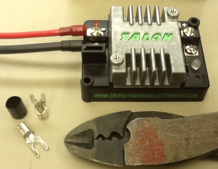

pic: Talon connected
Talon speed controller with power terminals connected. Leads are terminated using non-insulated spade crimps (McMaster p/n 8007K17) and then sleeved using 1/4" heat shrink tubing (McMaster p/n 7132K74 black, 7132K42 red). The black wire is 600V rated 10 AWG and the red wire is 300V rated 10 AWG, both PVC insulated UL 1569 30 strand 90 Celsius. The 300V wire is fine for FRC applications and save some space and weight compared to the thicker 600V.
Terminals were crimped using the Thomas & Betts tool shown.
All of the above can be used with Victor or Jaguar speed controllers also.
Very nicely done. Am I correct to say these terminals can be pushed on and off a loosened screw without the screw being removed? The terminals don’t permanently spread wide do they?
Thanks!
You are correct, the terminals are designed to “snap fit” on a #6 stud. The speed controller connection screws are slightly smaller than that, so the terminals slide on/off easily when the screw is loosened, and they don’t deform.
Could ring terminals be used or do the Talons possibly suffer from the same issue the tan Jaguars did with removal of the screws?
No, the talons do not have a problem with having the screws removed.

It looks like there’s an important difference between a Talon and a Victor. Victors have the (-) power input connection at the corner; Talons have the (+) connection there.
Yeah, same for the Jaguar.
Good observation. I’m having a tough time imagining why this would matter in any way other than them not being directly swappable in a built wiring harness. Is there any other reason this matters? I just want to make sure I’m not missing some important detail here.
It would matter because with both on a robot we’d need a new strategy for verifying the correct polarity of our speed controllers. “Check to make sure black is on the corner”, isn’t going to work very well.
For those of us who put our speed controllers next to the PDB, we won’t have to cross the power lines.
I knew there was something I was missing. If we do put our speed controls next to the PDB, this seals the deal for me. Thanks.
Bingo.
