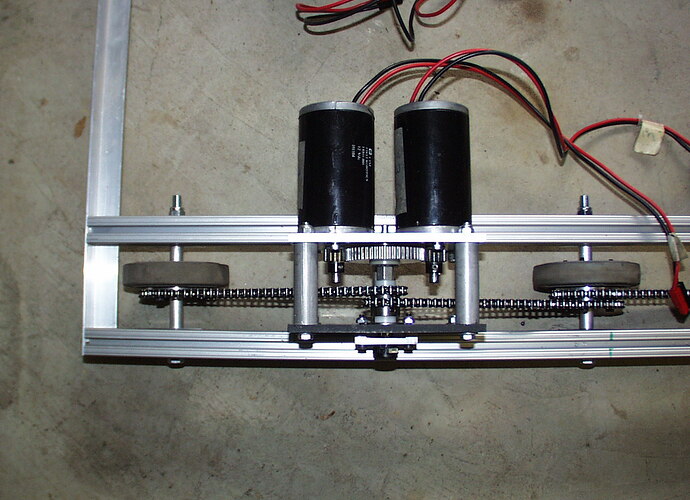

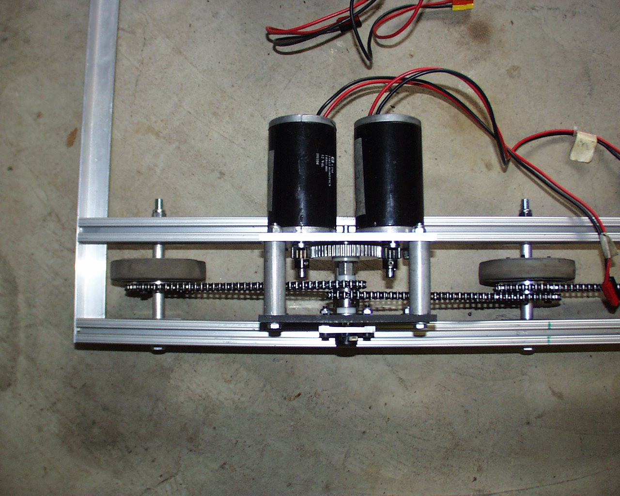

pic: Team 100 Gearbox
We decided to use some “custom” gearboxes on our offseason project.
They use a toughbox shaft and one 50 tooth toughbox gear :slight_smile: The only machining required was to make the plates.
With the added chain reduction to the wheels it works out to 11 fps.
