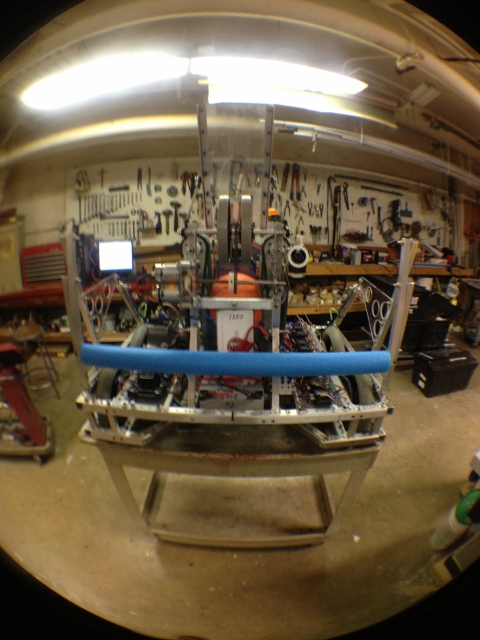

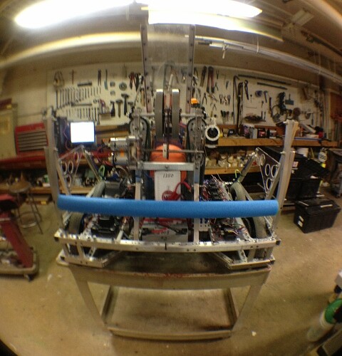

pic: Team 1350 Rambots 2012 Revealed -See you in Boston - Good Luck to All Teams!
4 Cim drive
12" Pnuematic wheels
wide style frame (with 4" + clearance, easily climbs over bump)
front and rear ball pick-up
2 stage ball lifter (holds balls until ready to shoot)
twin 775 shooter (allows rapid fire shots)
Camera aiming w/ringlight
Very consistant shooter from key or mid field
combination ball gatherer/ramp manipulator
Simple, Fast, Reliable - Bring on the Game!
He forgot to mention something, the intake doesn’t just passively work forwards and backwards. It actively shifts conveyor rollers to angle them to one side or the other.
Also, The bridge manipulator is awesome. Not only is it used for bridge lowering and ball collecting, but it also does… more stuff;) . I also like it because I designed linkage.
