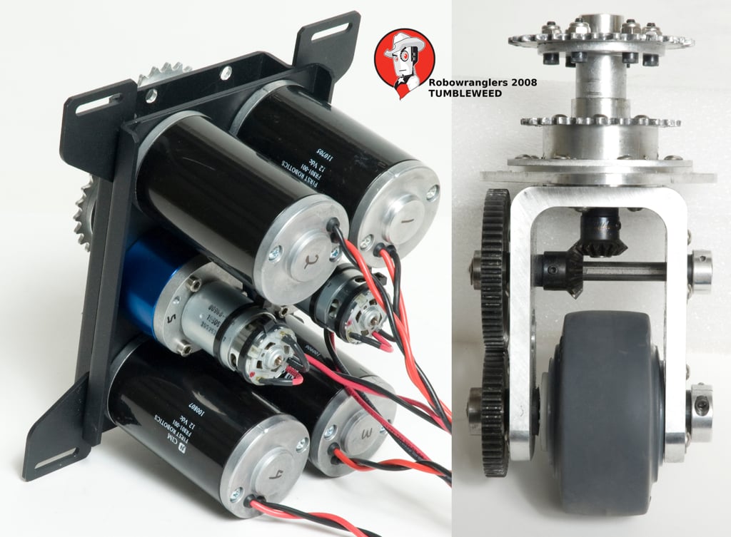

pic: Team 148 Robowranglers: Swerve Module and Motors
3 swerve modules, 6 drive motors. All the wheels are driven together, and steered together. You don’t need to turn when your robot has no “front”.
Some swerve module components were manufactured by team 217. The module design was inspired by the 2002 / 2003 Thunderchicken design.
are those custom built gearboxes for the fish?
Harrison’s design lives on :slight_smile:
AM Planetaries ?
Yes, AM Planetaries. John wanted ones that were red anodized, but we don’t have those yet.

I’m guessing this is it, with a very fancy and robust flagpole indeed. I count 7 victors and no relays on the electronics panel from what I can see. 6 victors for the central swerve gearbox and 1 victor for the module rotation motor (a globe probably) It looks like 148 is gonna be doing a lot of laps this year, I can’t wait to see it in action.

any chance of getting a shot of the other side of the transmission? It looks awesome. Also, what’s the top speed?

That completely defeated the problem with swerve/krab drive. Having to constantly rewind the wires on the drive motors. This here got rid if that! looks awsome!

How much does that gearbox weigh?:confused:
Holy cow I don’t know if the main breaker can even handle that much ampereage!
Do you have any trouble with anything popping/blowing if you slam it into forward (or switch directions)?

It’s nice to see the influence of such a prominent team, the Robonauts, displayed all around. Their idea of the V6 seems to have been simplified so wonderfully! I love how you rolled from their enormous system into such a small package.
Bravo!
Not to take anything away from the Robonauts, who clearly have a great design, but it seems like the decision to do what 148 did was simply out of necessity.
If you want to go 20 fps you need 6 motors.
If you need 6 motors and want to use a crab drive, you have to do coaxial crab.
If you want to save weight/complexity, you use 3 wheels.
If you use 3 wheels, you have to use all 6 motors in one gearbox.
I think both are each very much their own designs.
