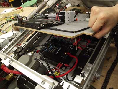

Shows how both top and bottom layers are arranged. The top layer is hinged, and can be folded open and out of the way without disconnecting any wires or pneumatic tubes.
