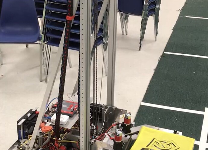

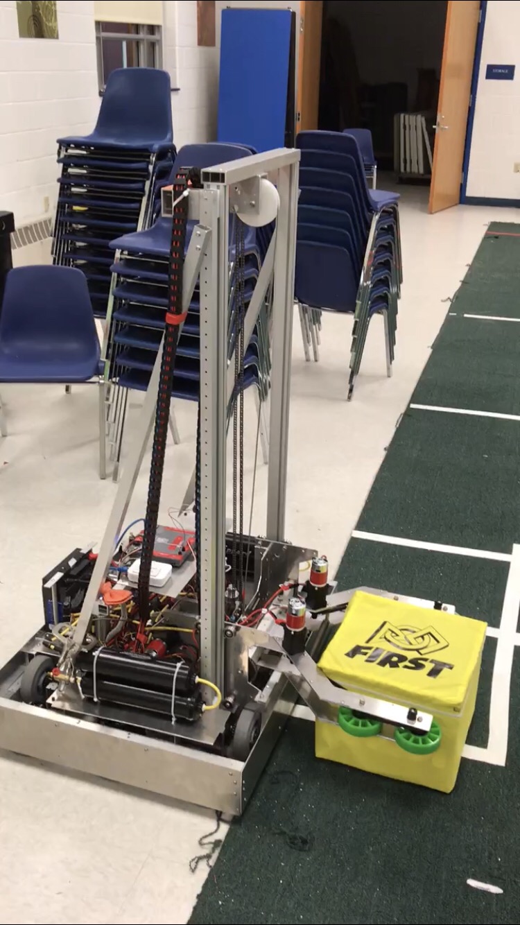

pic: Team 2495
This is are first robot reveal since 2013 and we are finally getting back to our roots as accomplished and confident makers.
Nice looking bot! What drive base did you guys end up using?
Glad to see you guys put out a nice looking bot! Can’t wait to see you at Seneca.
It is a set of two drivetrains, one drive train is always in contact with the ground and it can be raised or lowered by a pair of pneumatic pistons. so we can go in either the y or x axis. It is build with the versatility of tank drive as well so it can’t be pushed around. Sorry it took so long to respond
