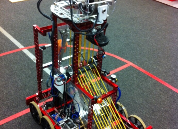

pic: Team 359 Robot: Ali'i Lopako
Our final 2012 robot.
Thanks to all of our mentors/students/volunteers/teachers for another successful build season.

That’s awesome. How do the bumpers attach to the sides where the wheels are?

If you look carefully at the pic, you will see mounting holes at the top of the frame on the sides.:slight_smile:

A couple questions,
Is that a FP motor in the gearbox driving your torrent?
Also does the PG71 on your hood drive a rack and pinion setup or something else?
Most likely they have a geartooth profile laser/water cut into a plate on their hood, creating a curved rack and pinion setup.

For our robot, we dont have a PG71 for the aperture of the shooter.
Its actually a P60 Banebot 256:1 transmission with a 550.
The rack and pinion is not laser-cut into the curved aluminum. However, we hope to have that capability by next school year.:rolleyes:
Its the same 25 chain setup being driven by a pinion gear as our turret, that does use the FP motor/plastic gearbox setup.
