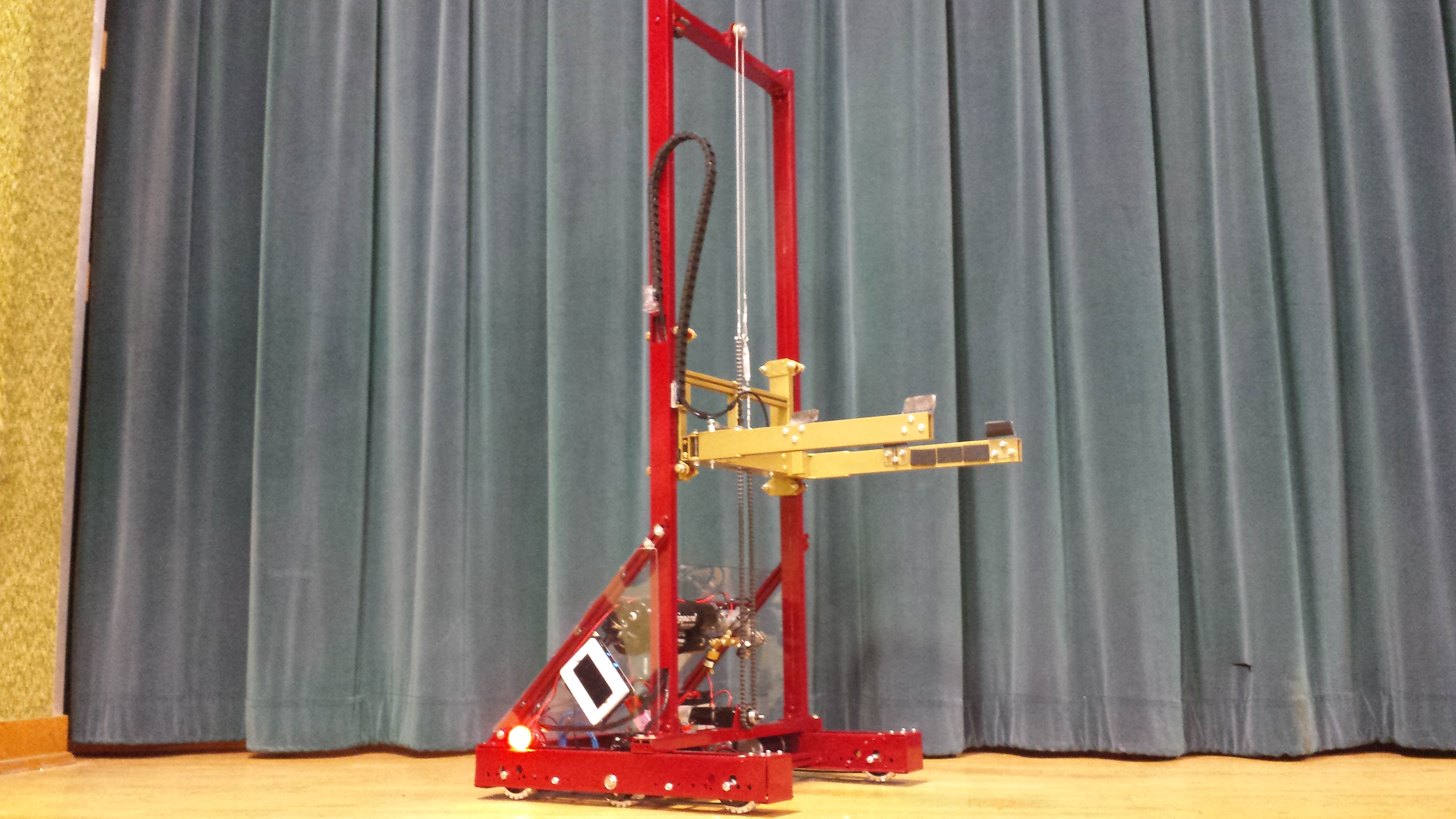

pic: Team 5012 Gryffingear presents: Fawkes
Team 5012 Gryffingear from Palmdale, CA presents our robot for Recycle Rush: Fawkes!

Specs
Drivetrain:
-AM14U2 chassis in square configuration, modified to have an open front.
-4 CIM drivetrain through AM Toughbox minis - 8.45:1 ~10 ft/s
Lift:
-2x1" 973/254 2011 inspired lift.
-35 chain driven
-Powered by Bag motor through a 100:1 Versaplanetary
Claw:
-Polycarbonate tab style pickup
-Pneumatically actuated open for tote adjustment and recycling container manipulation
