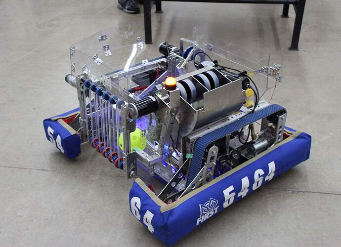

pic: Team #5464. Modified rhino track w/shoooter, gears, climber and fuel intake
What made you decide to go with the tank treads?
Any specs on the drivetrain power setup?
Really liking the two chamber shooter; how fast does it shoot? What about the drive train - how fast does the robot move in an open field? Can it traverse the field fast with all of the obstacles?
What about the climber? Can it easily find the rope and climb with ease?
We chose rhino tracks because A. we had them and they were paid for B. no one can move us around C. we can move anyone around D. they look cool :smiley: .
we have two CIM shifting gear boxes (3:1 and 30:1 reused from last year),
we have gotten quite good with the climber and in our best run were able to go from our shooting position to engaging the touch pad in 9 sec (avg of about 15-20 sec when being conscious),
the floor intake is fast, the shooter is has a high rate of fire however we didn’t have the encoder completely programmed by bag so we were forced to burst fire to prevent range drop, therefore i cant give any exacts on the firing rate.
Hope this helps and cant wait to compete with you this weekend
The question is will they be more useful than the KOP chassis. Honestly it looks sick, but I don’t think they were necessary. Plus many issues had come up in the past over them. Does it turn well?
It turns fantastic, since we discovered the faulty pulleys last year and brought it to andymarks attention the redesigned pulleys have not given us any problems
That is good to hear - because in this year’s game your drive train will need to be nimble and fast! No matter if you are a gear cycler, high-goal shooter, or defense, you better be ready to move quickly.

Tanks treads and a game where people are hanging round objects on pegs attached to a large central field element with no defensive protections. Nothing could possibly go awry in that scenario, right?
Use them with gusto - try some aluminum magnetry in pushing people sideways in the open field. Just take care when playing any defense around the airships.
