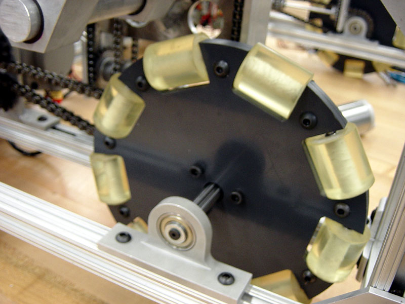

Here’s a closer pic of the omniwheels we’re using this year. They did amazingly at Chesapeake and with our treaded backwheels and chiapuas, allows for some amazing torque. The yellow stuff is 65 urethane; it’s hard yet very sticky on the HDPE. The black is lexan. Thanks to the guys at BorgWarner who helped us make these.
Btw, stop by our pits in the Canadian Regional to test out your torque; 500lb load tester with digital readout.

To answer the above questions:
A pair of them lasted us through the Chesapeake and Canadian regional events. They were specially designed [by students] for last year’s game to both stick very well on the HDPE and to clip onto the steel mesh of the ramp to provide extra traction :slight_smile: The lexan was incredibly strong and the urethane was durable.
That urethane was provided for us by BorgWarner Automotive. Our head engineer brought sample material and we liked that version best. Then our staff of on-call machinists cut it. Have you ever cut urethane? It’s about as hard as welding aluminium so we left it up to the pros. Even then it took a week before we got it back.

when these ran did the metal touch the ground?
No, the metal didnt touch, otherwise the wheel would have been illegal.
[edit] there isnt any metal on that wheel, barring the fasteners and the shafts the rollers run on. I think you’re referring to the lexan, which doesnt touch.

The two bolts are connected to a sprocket on the otherside that is connected to a main drive chain. The sprocket was keyed for the axle.
No, actually it wouldn’t be permitted. A wheel is by definition a traction device. You cannot have any metal touching the floor, no matter what. I believe the 2004 rules are even more implicit than the 2003 rule you just quoted.

Actually, the ‘machinist’ as we will call him, had to freeze the urethane to cut it nicely. Then he froze it again to drill the holes for the axles through it. Then, he placed each and every smaller urethane ‘wheel’ on a lathe and counterbored each side by hand, which took about 2 weeks, seeing as how urethane of that type is incredibly resistant to wear and extremely…squishy.
