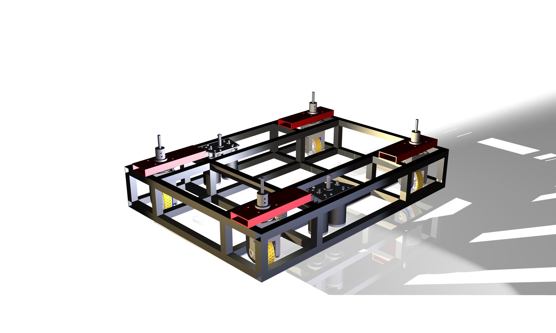

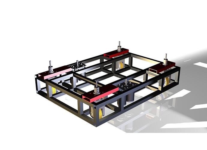

My team decided to try to attempt a swerve drive this year. This is what we have so far.
It looks really nice.
I have one question though, I only see two transmissions mounted, are these for the turning of the wheels or the module (I assume the wheels because they are cimple boxes). Just wondering on what you plan to use for the module turning.
it appears to be a coaxial crab drive with drive power supplied to the wheels through a shaft that rides inside the center of the crab module axis. at the top of each module you should see two sets of sprockets. the lower for steering. the upper for propulsion.
the trade off being you can rotate your modules arround and arround forever and not tangle wires, but with mechanical loss in the drive chain limits overall power put to the ground in cpmparison to motor-in module designs

yep. coax crab drive is the white elephant of first
If your team has their hearts set on building a coaxial swerve drive for this game, you may want to look into using the team 221 modules. Using an off the shelf module with cut down on the amount of development you’ll need to do significantly, just leaving you to design a frame, steering system and then working on the controls.
That being said, I’d listen to those in thread that speak against building a swerve drive during the build season - without having prototyped one in the off-season first. By the time you get the bugs worked out, your season may be over…
Thanks for your comments and concerns.
My team is in a better situation this year. We have more mentors, team members, a bigger build area, more money, better machining, basically better everything.
And then to add that, our sponsors are being extremely supportive this year and as a result we are making two different robots this season. One of them is a simple drive train, mecanum or 6WD (it can go between the two by changing wheels and adding the gear boxes). And the second is the swerve drive. We are also making a second robot to practice autonomous after ship. In other words we are working on both a simple and “stretch robot” this year.
I am handing the swerve modules off to sponsors tonight, and I will be handing the frame off either tomorrow or wednesday so yeah we are well on our way. And we are only directing a small amount of the team’s resources to the swerve drive, basically me and some of the mentors, while the rest of the team and mentors work on manipulators. We are almost done prototyping our lift out of aluminum and are beginning to work on the grabber. Our programmers have already started planning how the code will work.

But about the render it is old. I finished that on friday. I shall post a more up-to-date version soon.
