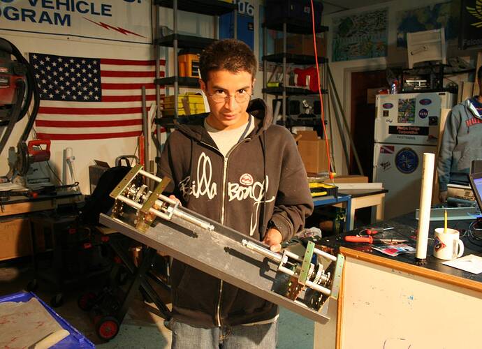

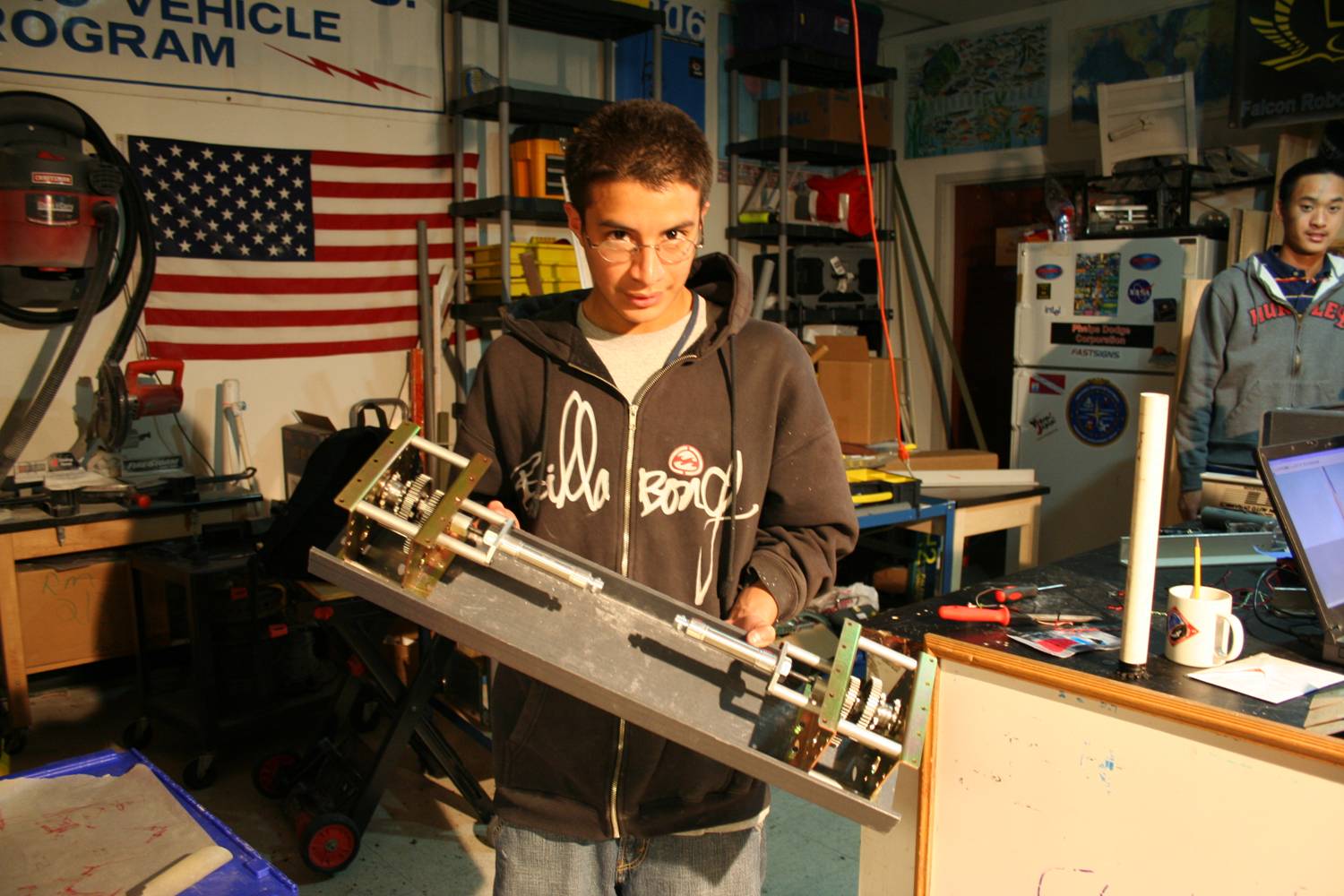

pic: Team 842 Tranmission Spine
Here is the spine in our robot frame. It also holds the two AndyMark 2 speed shifters. The spine is made of extruded fiberglass from CreativePultrusions.com.

Looks like we’ll be seeing another quality frame from you guys. I kind of wish my team had the resources to do the fiberglass or composite materal frame.
How much does your entire chassis weigh? (without motors or gearboxes, just the composite)
Check out www.creativepultrusions.com the prices vary for each type of material. It is more expensive than steel or aluminum but manufacturing time is cut way down. In the end is is far more cost effective and repair or rebuilding a piece that breaks during a tournament. All you need is a hack saw and some nuts and bolts and a dremel.
